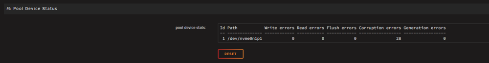

I noticed there are corrupted errors on the Cache drive where all the app-data resides: (NVME drive)image.png
I'm not sure if the NVME is failing or if there is something else that can be done to resolve it? Or if it should be replaced?

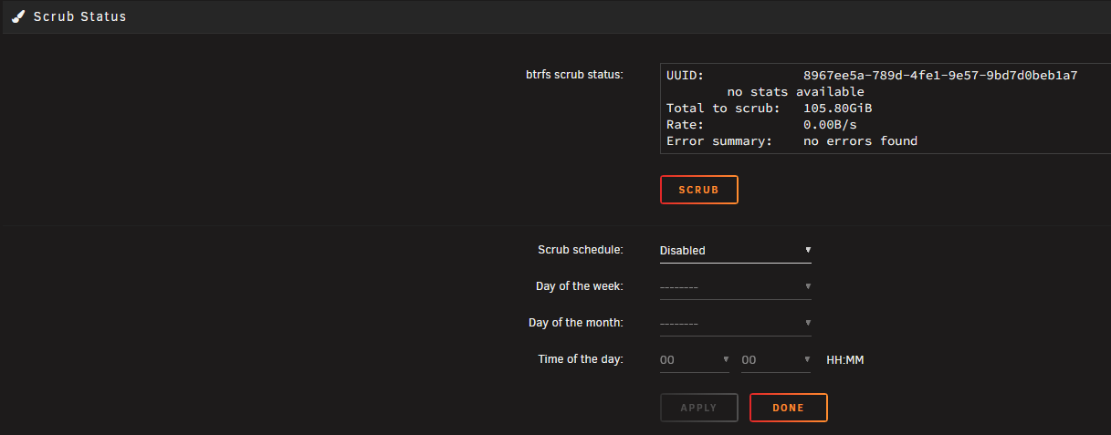

I see the scrub option below:
Just click the scrub button and post the results from the GUI when done.

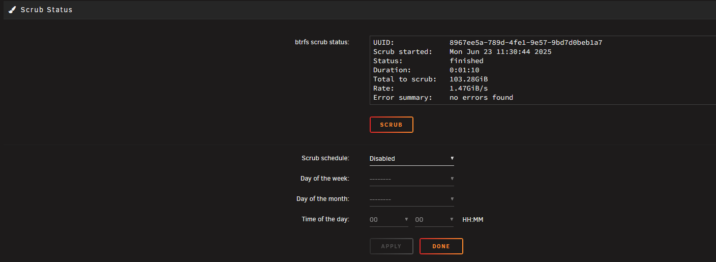

    Scrub also completed, please see below:

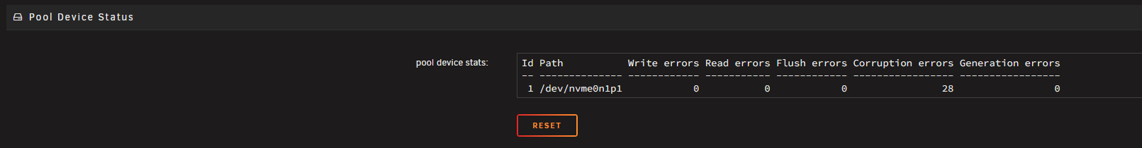

The corruption errors are still present

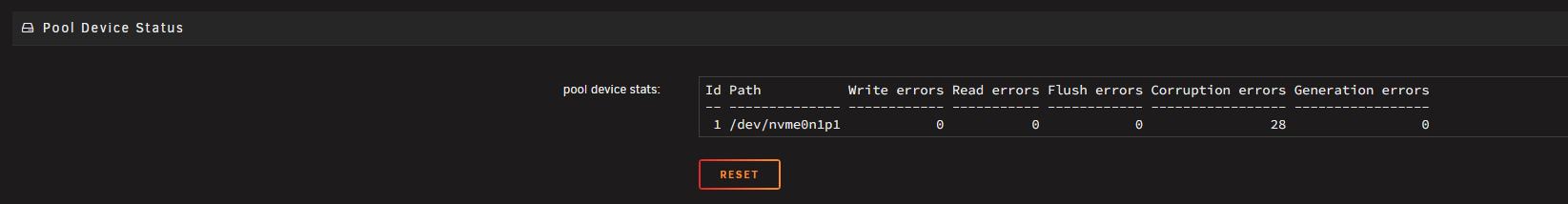

Anything that should be done below?
Thanks i have reset the stats and will be monitoring.

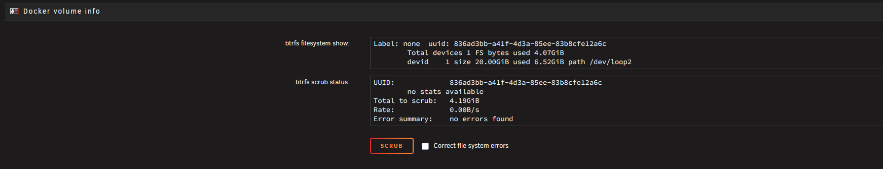

I have re-created the image this morning, and followed these steps provided to re-create the image and then installed the dockers from previous apps but i am still having issues with the one tdarr docker.
If the issue is just one container, better to look for support on its support thread/Discord:
