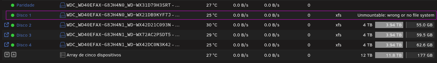

Yesterday, I finally checked, and one of the HDDs is showing the error: "Unmountable: wrong or no file system". Coincidentally, this is the same drive that previously had a faulty SATA cable.
I replaced the cable, but the error persists.
Another issue I noticed is with ErsatzTV, which I use to create IPTV channels. It reports when media files become unavailable, and it’s now showing around 4,000 media files as missing from my total of over 10,000. I checked some of these files manually, and they are indeed gone. I believe they were on the HDD that’s now unmountable.
However, shouldn’t Unraid emulate the data in such cases?
I’d like to know how to proceed in this situation, and whether it's possible to recover the drive and the missing data.

Check filesystem on disk1.

The Check filesystem result:

I try to click on "FIX" and receive this message:

Note: While there is some risk, if it is not possible to first mount the filesystem to clear the log, zeroing it is the only option to try and repair the filesystem, and in most cases it results in little or no data loss.
Destroy the log, it's the only option, and it's usually safe.

After destroy log, this is result:
Phase 1 - find and verify superblock... Phase 2 - using internal log - zero log... ALERT: The filesystem has valuable metadata changes in a log which is being destroyed because the -L option was used. - scan filesystem freespace and inode maps... clearing needsrepair flag and regenerating metadata sb_ifree 701, counted 700 sb_fdblocks 15208003, counted 22022919 - found root inode chunk Phase 3 - for each AG... - scan and clear agi unlinked lists... - process known inodes and perform inode discovery... - agno = 0 - agno = 1 - agno = 2 - agno = 3 - process newly discovered inodes... Phase 4 - check for duplicate blocks... - setting up duplicate extent list... - check for inodes claiming duplicate blocks... - agno = 0 - agno = 1 - agno = 3 - agno = 2 clearing reflink flag on inodes when possible Phase 5 - rebuild AG headers and trees... - reset superblock... Phase 6 - check inode connectivity... - resetting contents of realtime bitmap and summary inodes - traversing filesystem ... - traversal finished ... - moving disconnected inodes to lost+found ... Phase 7 - verify and correct link counts... Maximum metadata LSN (5:1740302) is ahead of log (1:2). Format log to cycle 8. done

After this, I started the array on normal mode, my disk back to life with all the space used, I believe my media is back, I'm just waiting for the program to check if anything is missing.
