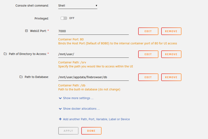

I have installed it in docker of Unraid
my setting is:

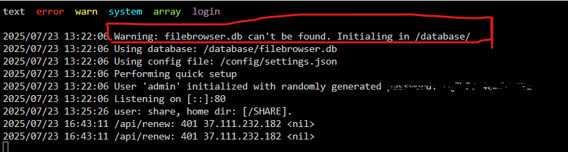

but file browser log error message is :
database.pngHey,

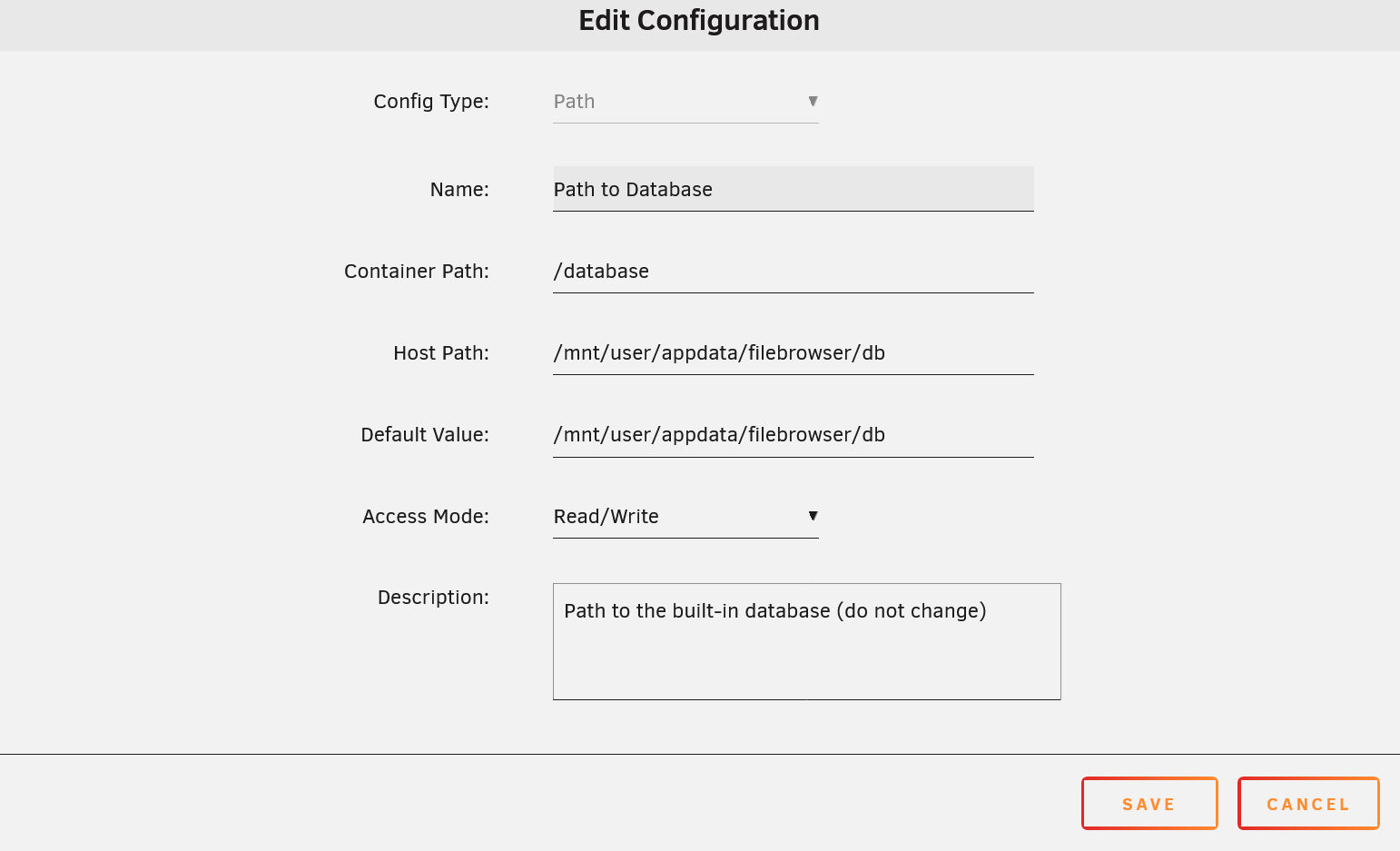

click next to Path to Database on Edit. Then change Container Path from /db to /database
Edited by Sepp2Depp

This is exactly the solution. I was having a similar issue where the template maps to /db, so the db file was being destroyed every time the container restarted and I'd have to use the temp admin password from the log to re-login.
