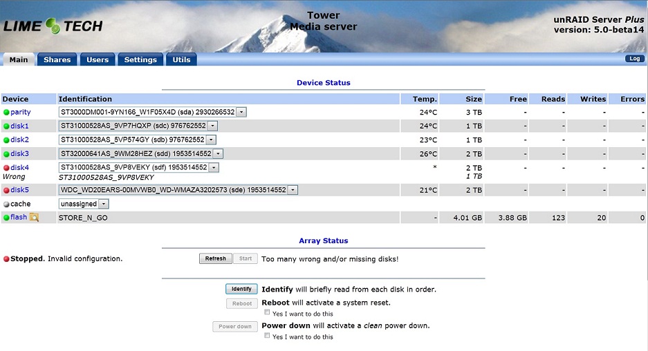

Was copying some movies up to the server today and got errors. Before this, all was working ok. I am 5.0-beta14.
Disk 5 was blinking red and showed errors in the error counts. I stopped the array. Then after the array was stopped, Disk 4 says "WRONG" - see screen shot.  I was copying via robocopy and forgot about it for a while so the errors are repeated in the log, which is also attached, as robocopy kept retrying.
I am afraid to do anything at this point without some help.

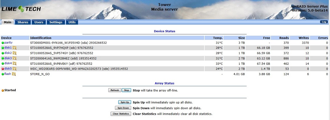

Joe,
I reseated the cables and restarted.  The array started. Disk 4 no longer has a red button, but Disk 5 does on the UI page (scrrenshot attached).
I ran smartctl and it now finds disk 4. (whew).  No errors on the smartctl, report attached.
I ran smartctl on disk 5 again.  Same error as last time. Report attached.
I ran the reiserfsck --fix-fixable /dev/md5 again.  It said Partition /dev/md5 is mounted with write permissions, cannot check it.

I found in the wiki how to run it. It found 1 issue and was fixed. Below is the process.
I rebooted again.  Disk 5 is still red -- what is causing this - the error on the smartctl report?  Syslog from the latest boot is attached.
