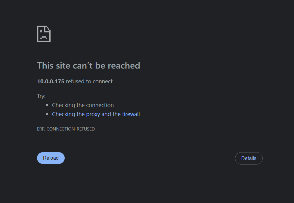

So this is, likely not directly and unraid issue since my phone can see the server just fine but thought I would ask for any ideas here because its driving me crazy. I was just in radarr doing some cleaning of stuck downloads and then my PC just stopped being able to see the server. When trying to go to it on my local network it just ive me a "This site can’t be reached" message. I have tried chrome, firefox, brave and edge all of the same problem. Restarted server and PC, even did a restore on my PC in case something happened that I didn't know. I flushed DNS, refreshed etc, changed DNS to a static google DNS and even restored all network adapters to default, but still no luck. If I go on my phone, which is connected to the same exact network, it loads up just fine and no issues there. My mapped network drives also wont load so its a full PC issue. I am honestly not sure what to try now and its driving me crazy. Nothing has changed on my server or PC in the last couple days, especially not from when everything was working to two seconds later when it wasnt.
Also forgot to mention it at first but pining my server ip comes back just fine, I also tested it on my GFs computer and webUI pulls up there just fine so its just my computer

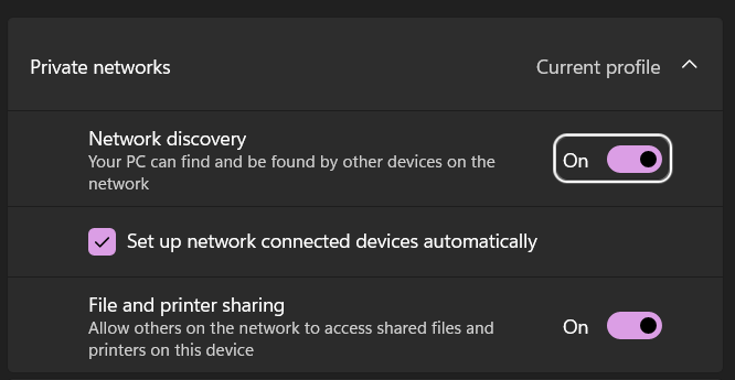

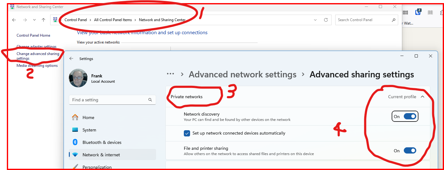

It could be that it (somehow) has become configured to behave as if it was. That is one of the purposes of the 'Public' network type setting that Windows has. To allow a Windows computer to use a Public network (McDonald's, Airports, coffee shops, etc) with as much protection as possible in a potentially hostile environment.
Check to see what these settings are in Control Panel (You can get to it from Settings but it has even more steps than this approach):
Just checked and it was already set up like this,
