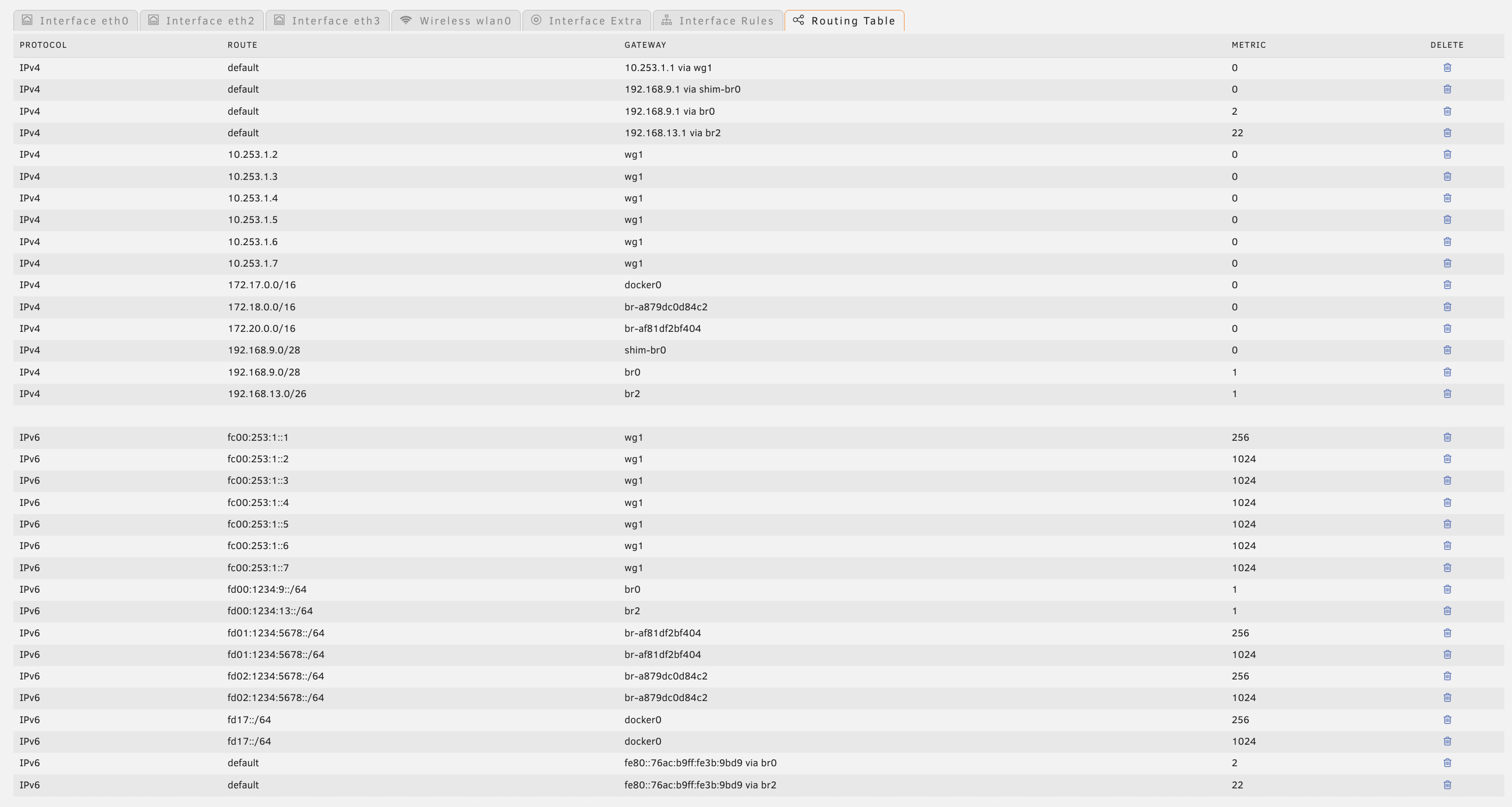

Here is a screenshot of my routing table. There is no equivalent ipv6 shim-br0 network. Is that the issue?
