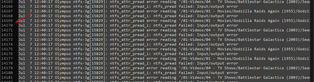

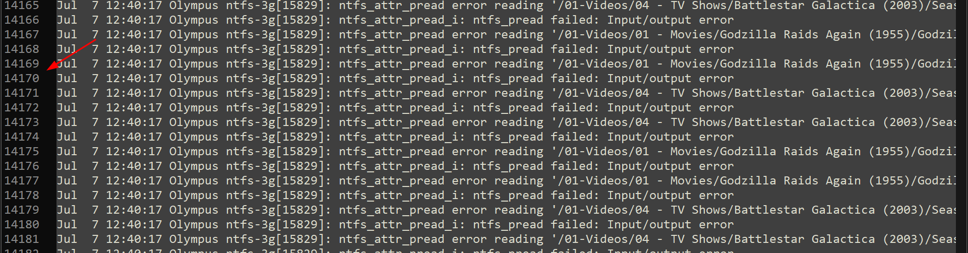

VAR log 100% Full accoding to Fix Common Problems
Hi, Fix common problems is saying: "/var/log is getting full (currently 100 % used)" Can someone explain what that is and how to fix it beyond just constantly restarting my server?
Thanks
well, pretty easy, take a look at your log what is spamming it ... sample, thousands of errors like this
may some external USB disk ?
the log is stored in a (limited) ram disk to avoid things like this could crash your entire Server, as alot are not checking the logs and then ...
so in the end, if this happens, something is wrong ... you see "what" in the log, fix it and then this behaviour is gone ;)
