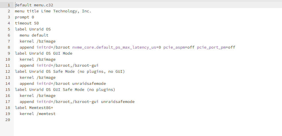

NVMe device dropped offline. Try adding the kernel options mentioned to syslinux.cfg and then reboot, it helps in some cases.
like this?
Yep, now reboot and see if it helps.
