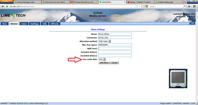

I am using 5.0-RC3 but I do not see any options to create a share and set it to "only use cache drive".  Where do I go for that?
Where you set up the share.
"Use Cache Disk" set to "only"
Thanks, I was looking for a "Use Cache Disk Only" -- Yes / No button....  :-\
