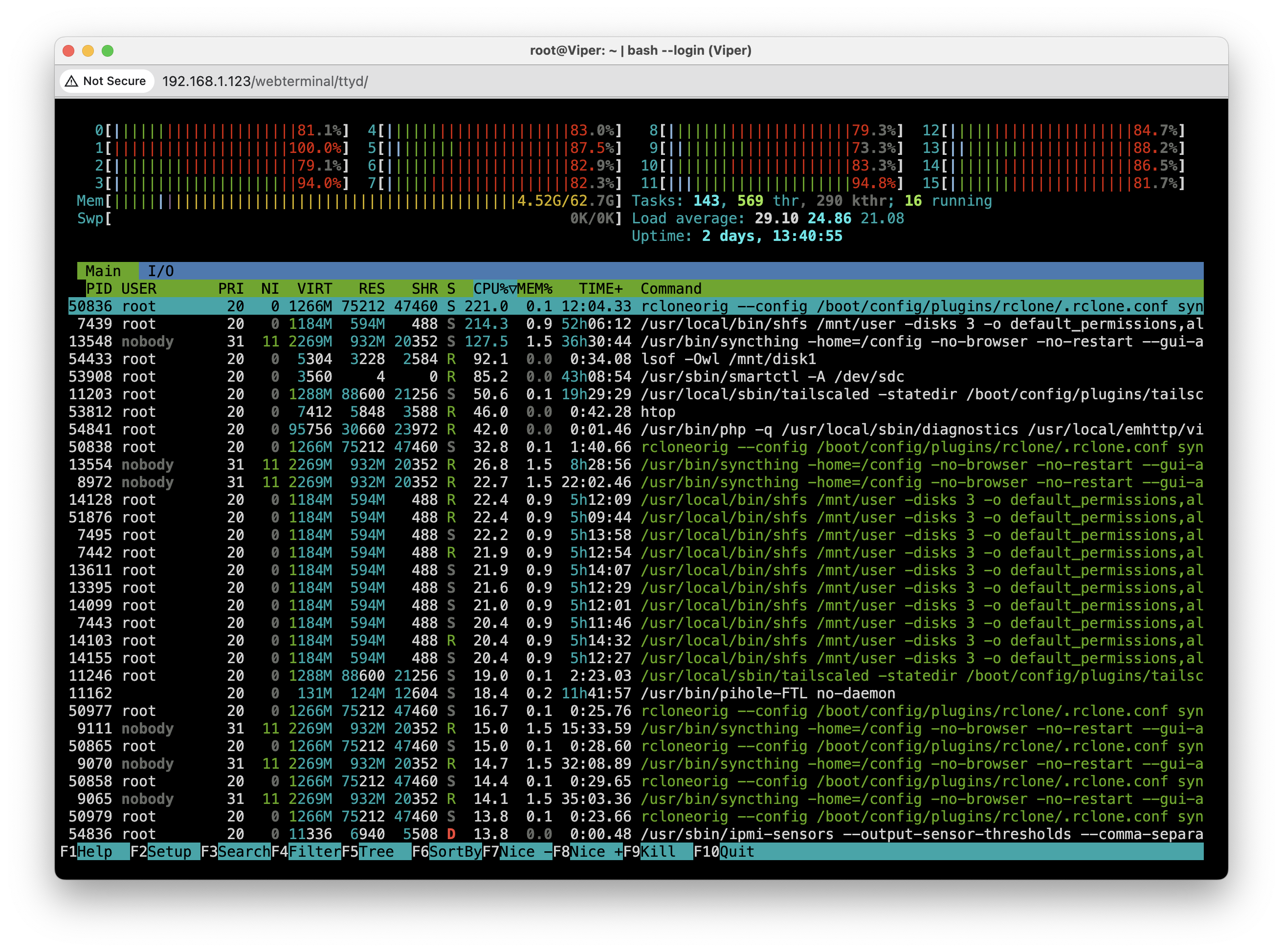

July 26, 2025Jul 26 Hello!I know this has been asked before but I've not found a discussion that correctly matches the symptoms of my issue. I've been running unraid with no issues for 2-3 years. I have a small Supermicro box with two physical disks and an NVM drive used for cache. I have 3-4 Docker containers (pihole, syncthing, unifi-protect-backup, and route53 dns updater). I also have a VM running HACS.My server keeps coming unresponsive due to the parity check process and when I catch it and I'm able to log in I just see 100% (or close to) CPU utilisation across all the cores and a most of the CPU being chewed up by shfs processes. I have tried a few things including moving docker instances from /mnt/user to /mnt/cache where appropriate as well as reducing the number of applications running. Unfortunately I still seem to be getting this recurring issue and I can't figure out what changed or what I'm doing wrong. Here's an example htop from today during a parity check:I've also attached my diagnostics dump.I'd be grateful if anyone can suggest how to diagnose and resolve this issue! viper-diagnostics.zip
July 26, 2025Jul 26 Community Expert Parity check should not have anything to do with shfs, other than possibly making i/o slower. Does it still happen if you disable rclone during the check?
July 28, 2025Jul 28 Author I've tried shutting down syncthing which I presume is driving that but it's not made a huge difference. The instance of /usr/sbin/smartctl -A /dev/sdc is using a large amount of CPU and has been running for 90+ hours - is that normal?
July 28, 2025Jul 28 Community Expert Nope, try rebooting in safe mode and leaving all services disabled, then retest. If all looks OK, start re-enabling them one by one.

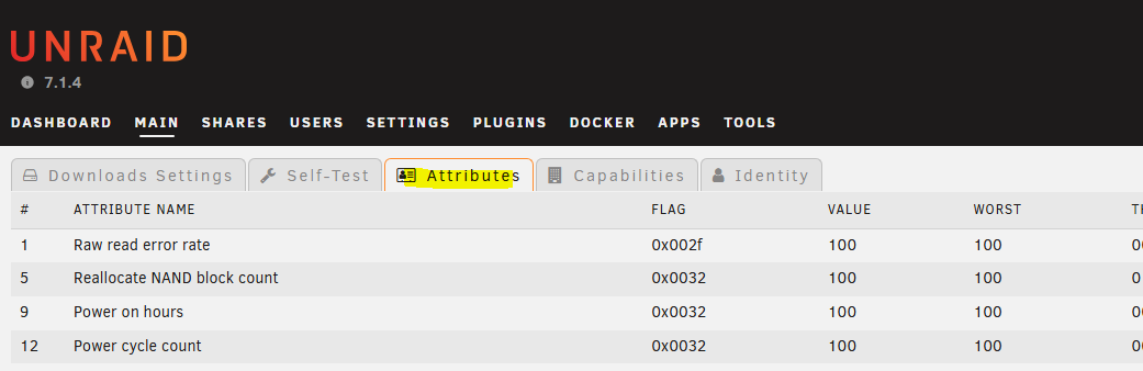

July 28, 2025Jul 28 Community Expert It could be GUIm if you tried to look at a device's SMART attributes.
July 28, 2025Jul 28 Author I'm not sure what that is. Can you explain a bit more about what I should be looking for?
July 28, 2025Jul 28 Community Expert Made a typo, I meant using the GUI to look at a SMART data:If you didn't do that it could have been Unraid just getting the temps, for example, or a plugin.
