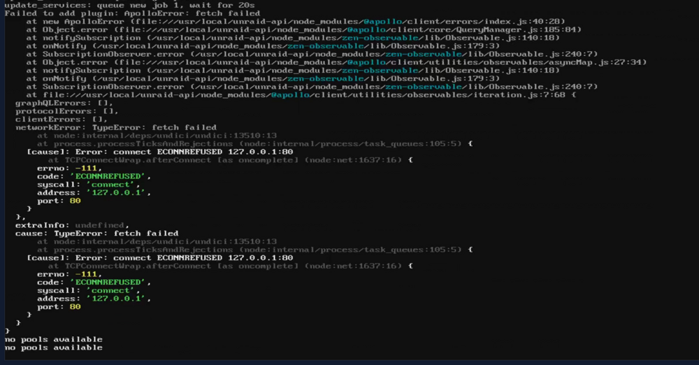

Because of an stuck VM I had to hardreset my UnRaid via KVM is was Monitoring the boot and got the following Error.
From the Error Stack it looks like this is coming from the UnRaid Connect Plugin.
On the Systemlog at the WebGUI i can't see any issue.
Attached is also the Diagnostic, maybe this could help.

Please update Unraid Connect and let me know if you’re still having this issue!
Looks like after the Update, the Error is gone!
Thank you for your help!
