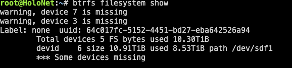

  5. Unmount everything after unsuccessful mount and check btrfs filesystem show.
The btrfs filesystem show doesn't show all 5 devices or even a placeholder for all of them.
Is there a good way to resolve this, or would there potentially also be a different btrfs-specific forum to check?

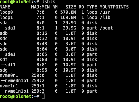

After doing an lsblk, it looks like the sdd1 and sdg1 partitions are missing

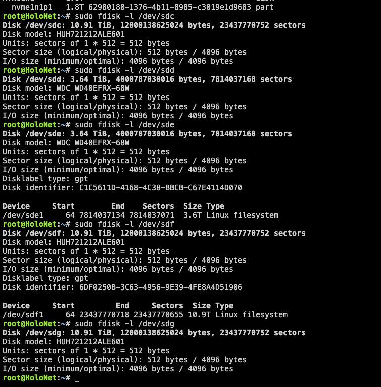

Using fdisk, I can seee that some of them show up as having partitions while others don't.
Screenshot 2025-07-31 at 22-07-21 root@HoloNet ~ _bin_bash --login (HoloNet).png
There are 4 missing devices, any idea what happened to the partitions?

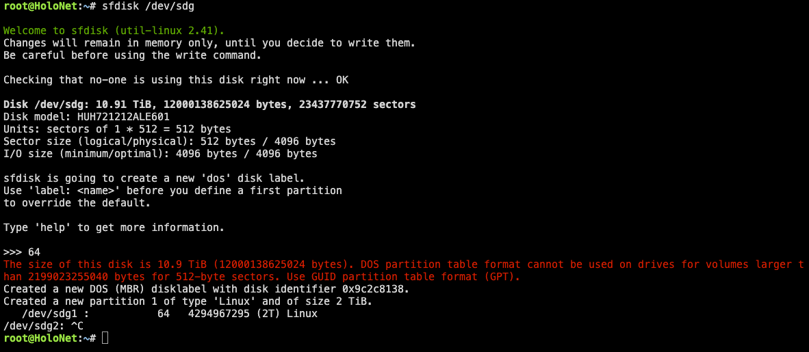

Assuming sdg was part of the pool, type sfdisk /dev/sdg and enter, then type 64 and enter, then hit CTRL + C to abort, capture that output and post here.
I think that unraid got rid of their association as a pool when I tried to mount them through the pool devices frontend. I wish that I copied the data to a different drive before trying to mount it with unraid since I did get it working again on the command line.
Screenshot 2025-08-01 at 17-34-42 root@HoloNet ~ _bin_bash --login (HoloNet).png
Before I mounted them with unraid, they did have the partitions listed when using lsblk, but they aren't there anymore after attempting an unraid mount. There were initially gaps in the grouping, so that may also be why it had an error. I had two failing drives and needed to do a replace and then a remove and then another replace, so I ended up with something like:

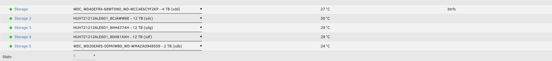

I then unmounted the drives and then added them like this, which then broke the array when I tried to mount it.

There's no BTRFS signature on that disk, try the same command for all the disks that were part of the pool and don't have a partition, always abort after entering 64 and post the output, it's just to see if a signature is found; we don't want to use sfdisk to create the partitions.
