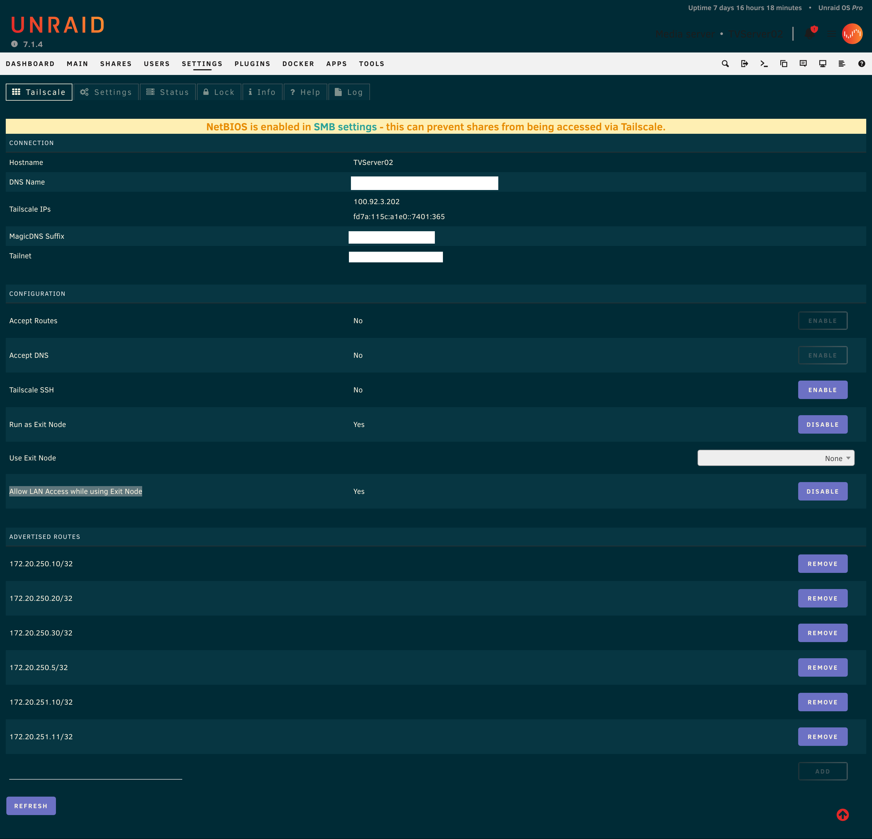

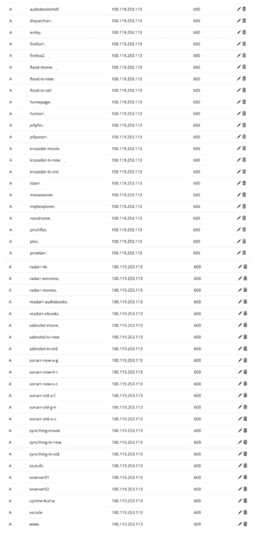

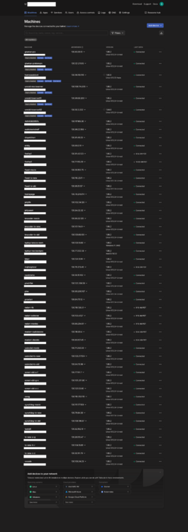

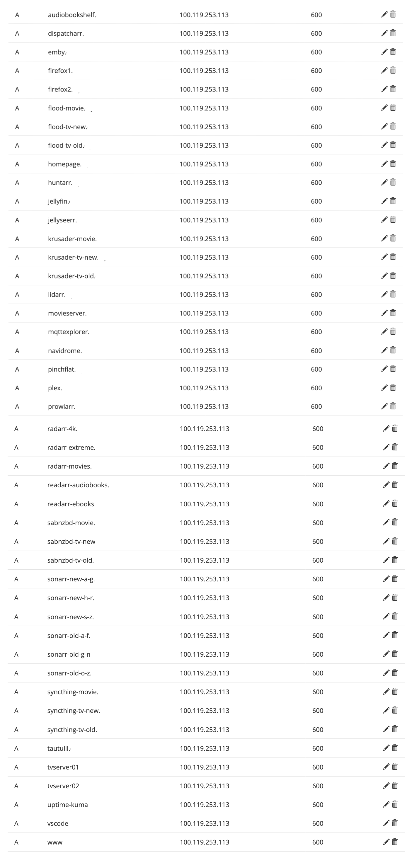

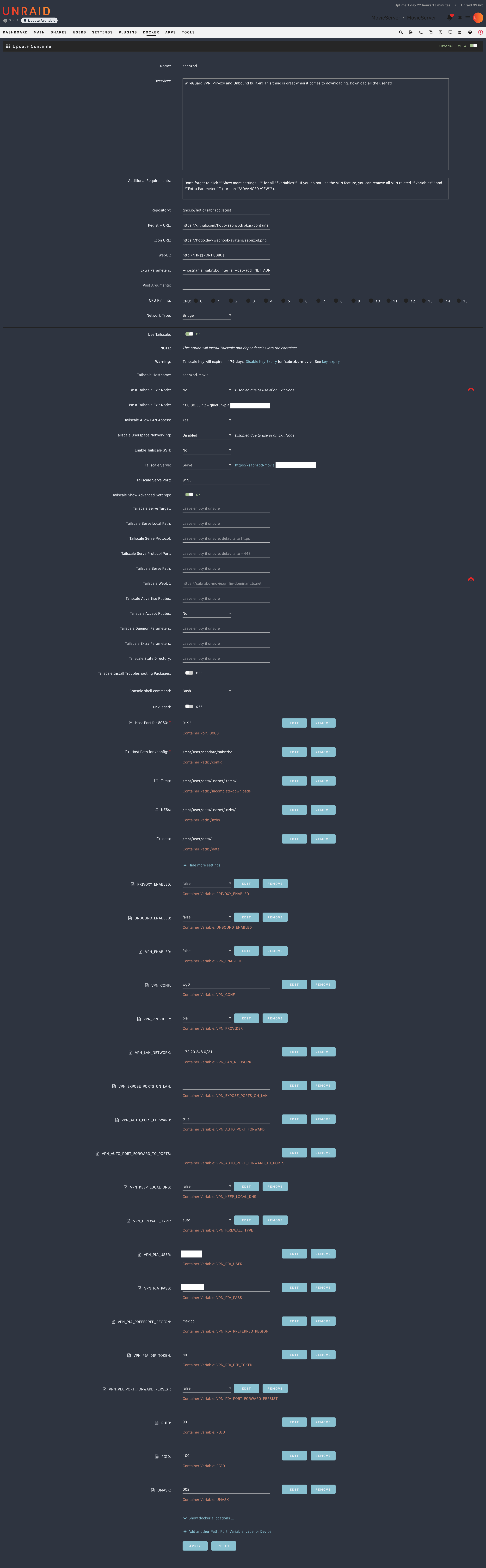

I have 3 Unraid Servers all 3 are on the same local subnet 172.20.250.x. I have configured all 3 servers as exit nodes, as well as Allow LAN Access while using Exit Node, and, available routes specified for the IP's of all the various clients. See example image attached (Tailscale Server Config). I have SWAG container running on one of the servers, i have A-records for my domain mapped to the SWAG Tailscale IP (Tailscale Clients / A-Records).

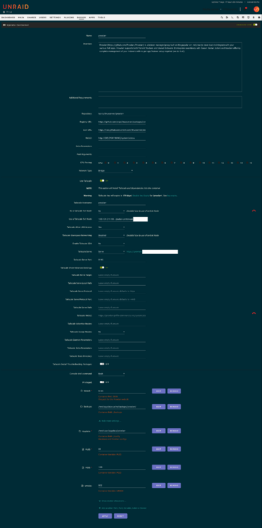

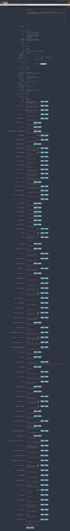

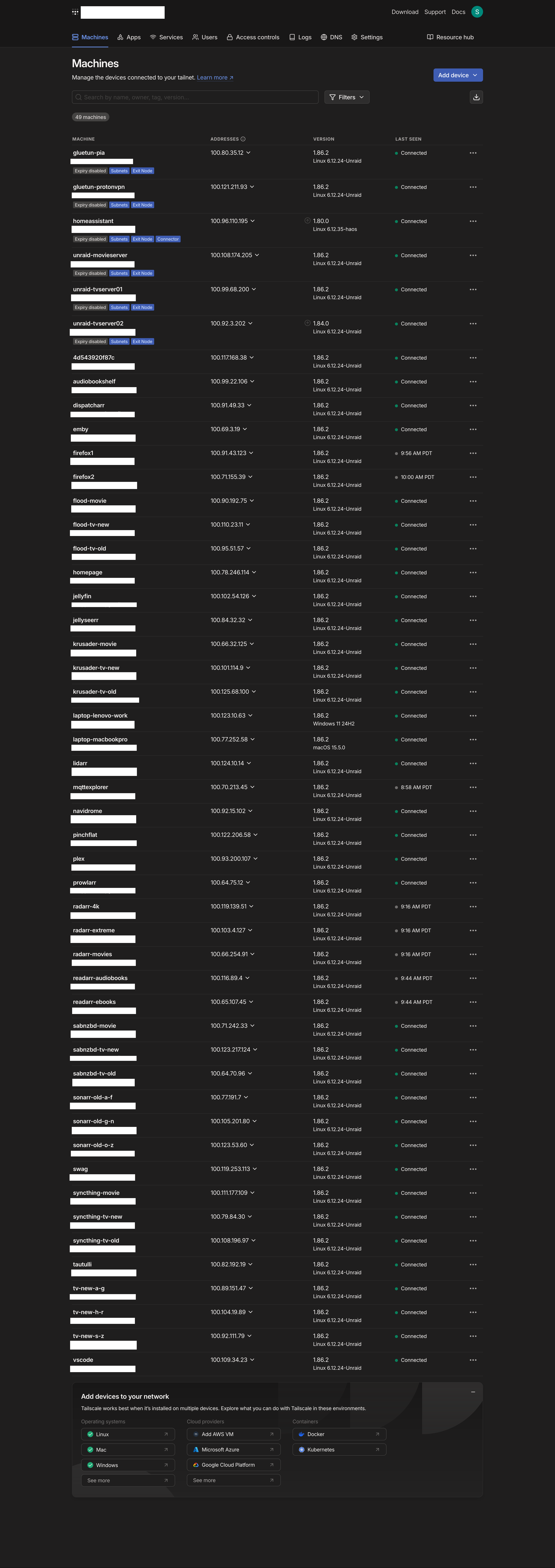

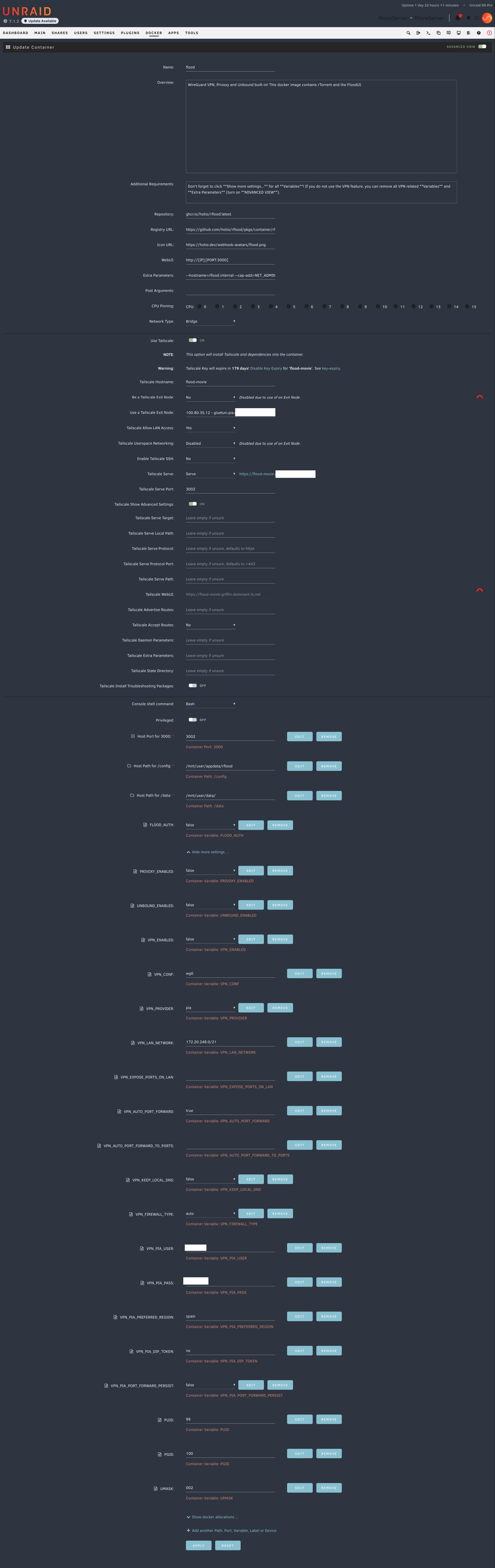

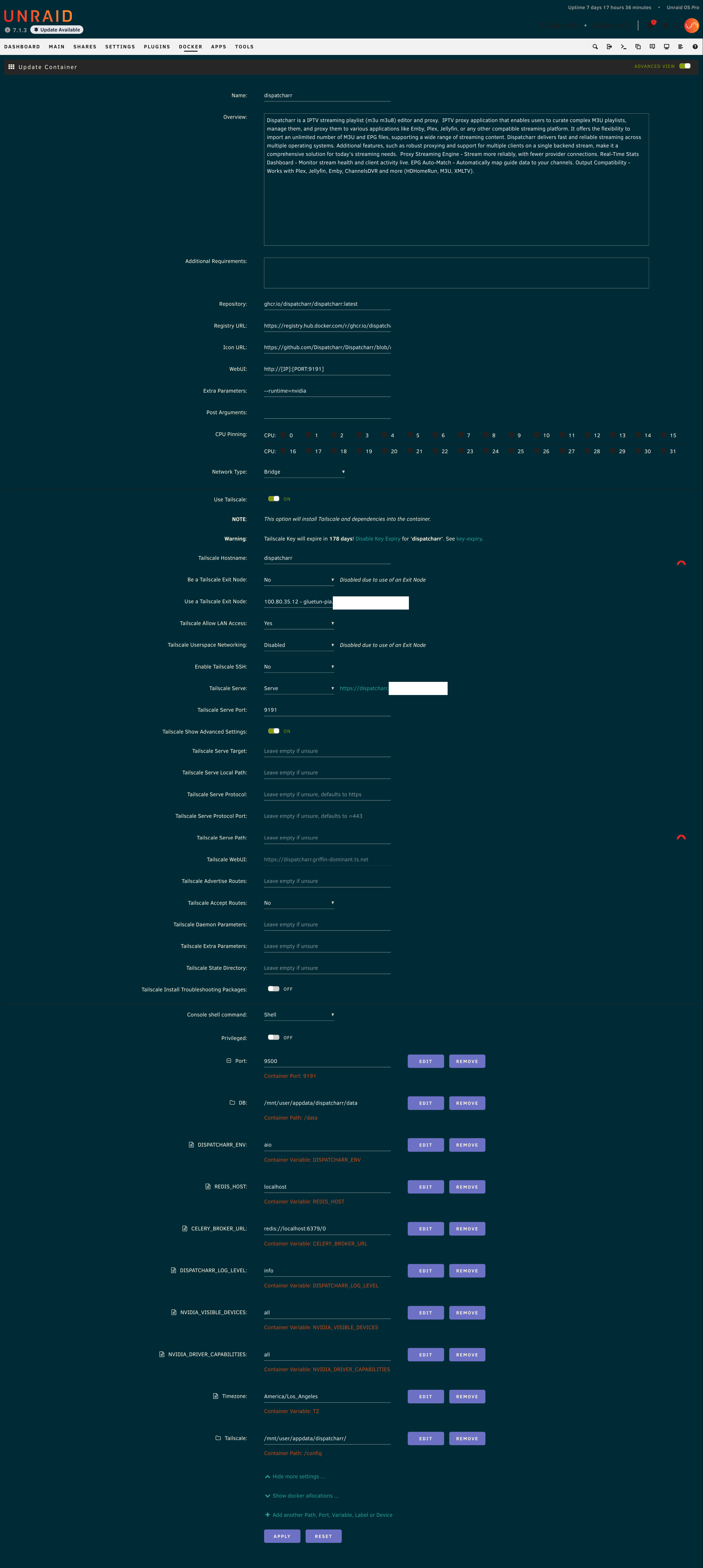

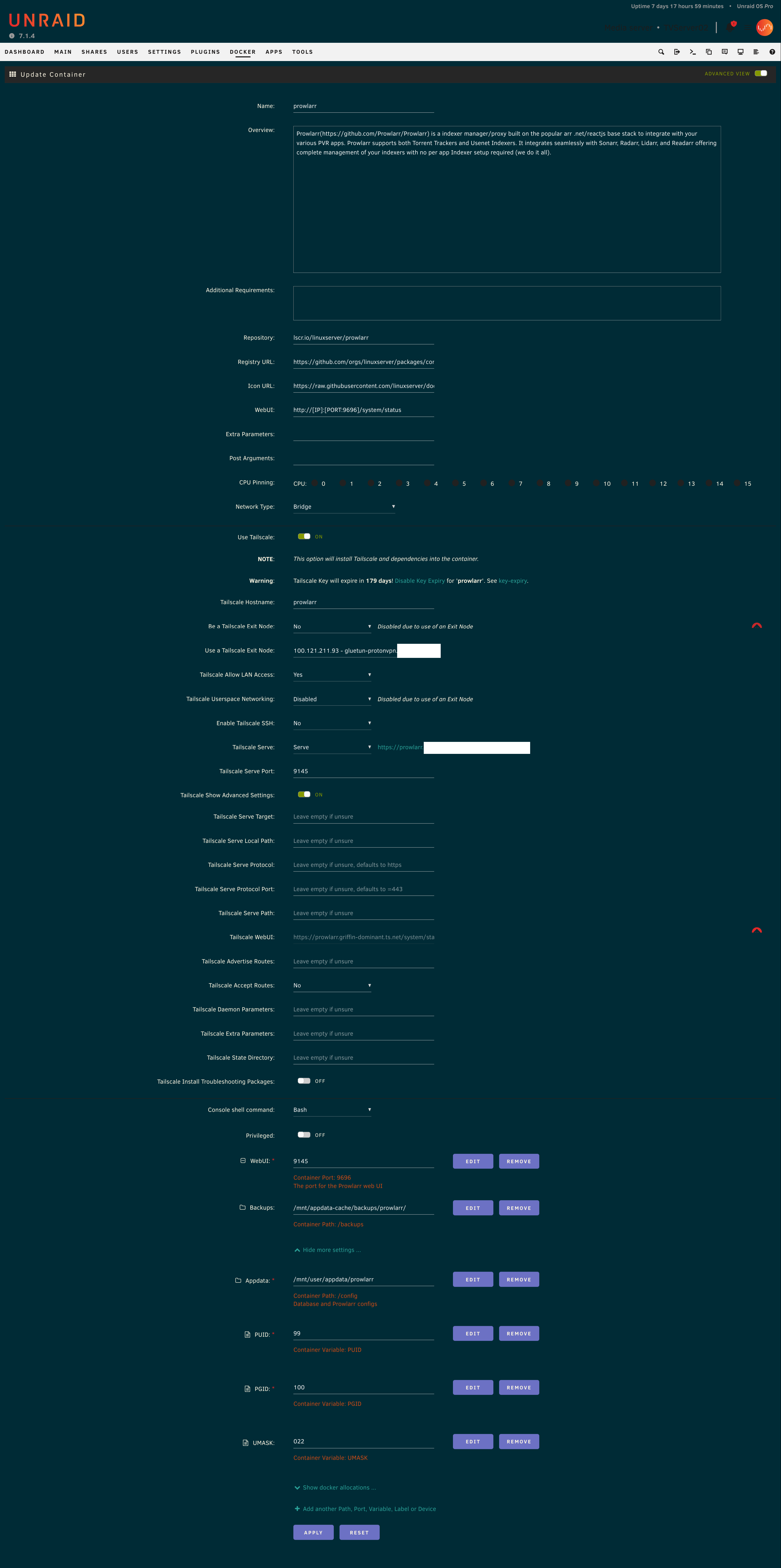

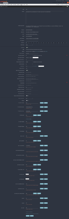

I have included a few different examples of configs including the Gluetun config, and a few of the configs for clients (Prowlarr, rFlood, sabnzbd) i am trying to use the Gluetun container as an exit node. Oddly enough Dispatcharr is the only container that is accessible in all the proper ways, while using a Gluetun exit node. So i included it as well.
