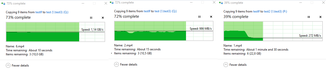

Both of those suggest a LAN issue, despite the good iperf results; see the examples below:
1st one shows the expected line speed for 10GbE, the 2nd one shows a LAN issue, and the 3rd one shows a device limit, since the initial transfer is fast, while it's being cached to RAM, meaning the LAN is OK, then it's limited by the actual device write speed, since you are seeing slow speed from the start, it suggests a LAN problem, assuming the source device is fast enough, of course.

Updated setting and made the cache exclusive share. Confirmed exclusive access was yes. Here is the Windows transfer chart now:
Initial speeds were over 600MB/s, so we're definitely heading in the right direction. I assume this involves the pseudo-SLC cache on the 860 EVO, which is 22GB and improves initial write speed. However, the file is only 14GB, so I'm not sure why it wouldn't be able to sustain the increased write speed for the whole file.
The graph now suggests a device limit, 300 MB/s sustained write speed for the 860 EVO is about right in my experience.
