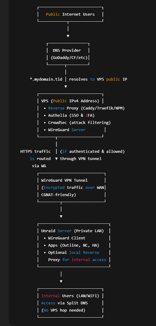

You’re basically trying to solve two problems:
  1. Get traffic from the internet to your Unraid services despite CGNAT.
  2. Secure it with authentication, geo-blocking, and possibly WAF-like protections.
Core Architecture
Because you’re behind CGNAT, you can’t just open ports from home — you’ll need the VPS to act as a reverse proxy “bridge” to your LAN.
Internet → VPS (reverse proxy) → VPN tunnel → Unraid services

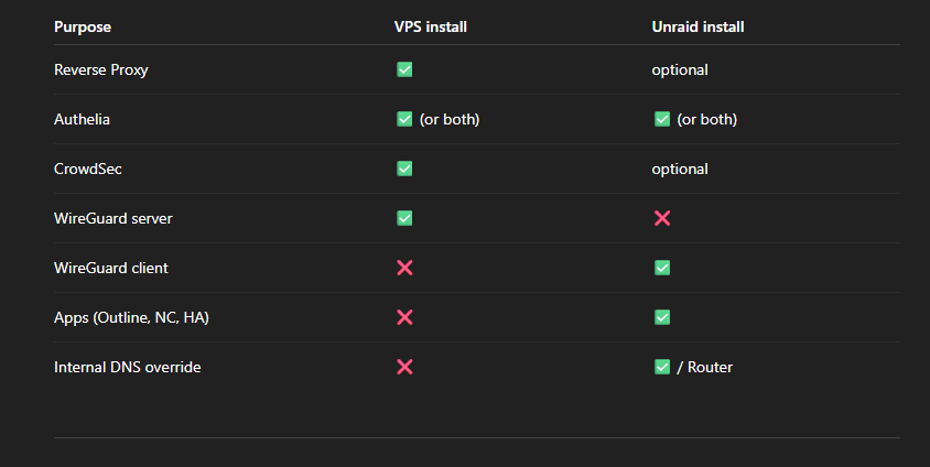

Where each component lives
  • VPS (public IP, Debian/Ubuntu)
    • Reverse proxy (Nginx Proxy Manager, Caddy, or Traefik)
    • Authelia (can also run on Unraid, but many put it on the VPS so auth happens before traffic enters LAN)
    • CrowdSec (optional, for attack mitigation)
    • Firewall rules (UFW, iptables, or provider firewall) + GeoIP filtering
  • Unraid (private network)
    • Your apps (Outline, Nextcloud, Home Assistant, etc.)
    • Optionally Authelia (if you prefer local auth instead of on VPS)
    • VPN server/client (WireGuard or IPsec) connecting to the VPS
    • Internal reverse proxy for LAN access (NPM, Traefik, Caddy)
    • Split DNS so wiki.mydomain.tld resolves locally when you’re at home

Flow explanation:
  1. User types wiki.mydomain.tld in browser.
  2. DNS sends them to the VPS’s public IP.
  3. VPS reverse proxy receives request, checks Authelia (SSO, 2FA, access rules).
  4. If allowed, VPS sends the request over WireGuard VPN to your Unraid server.
  5. Unraid’s app container serves the page back via the same VPN tunnel → VPS → user.
  6. If you’re at home, split DNS means your browser talks directly to Unraid’s LAN IP, skipping the VPS.

[you go to domain name > authelia to 2fa auth first or RP{reverse Proxy} to authelia for 2fa (order of operations vary....)... where RP points to app in your example outline... > connects over wireguard to your unriad > outline system auth and app access via RP...]
as explained in the table and outlined pictures above...
