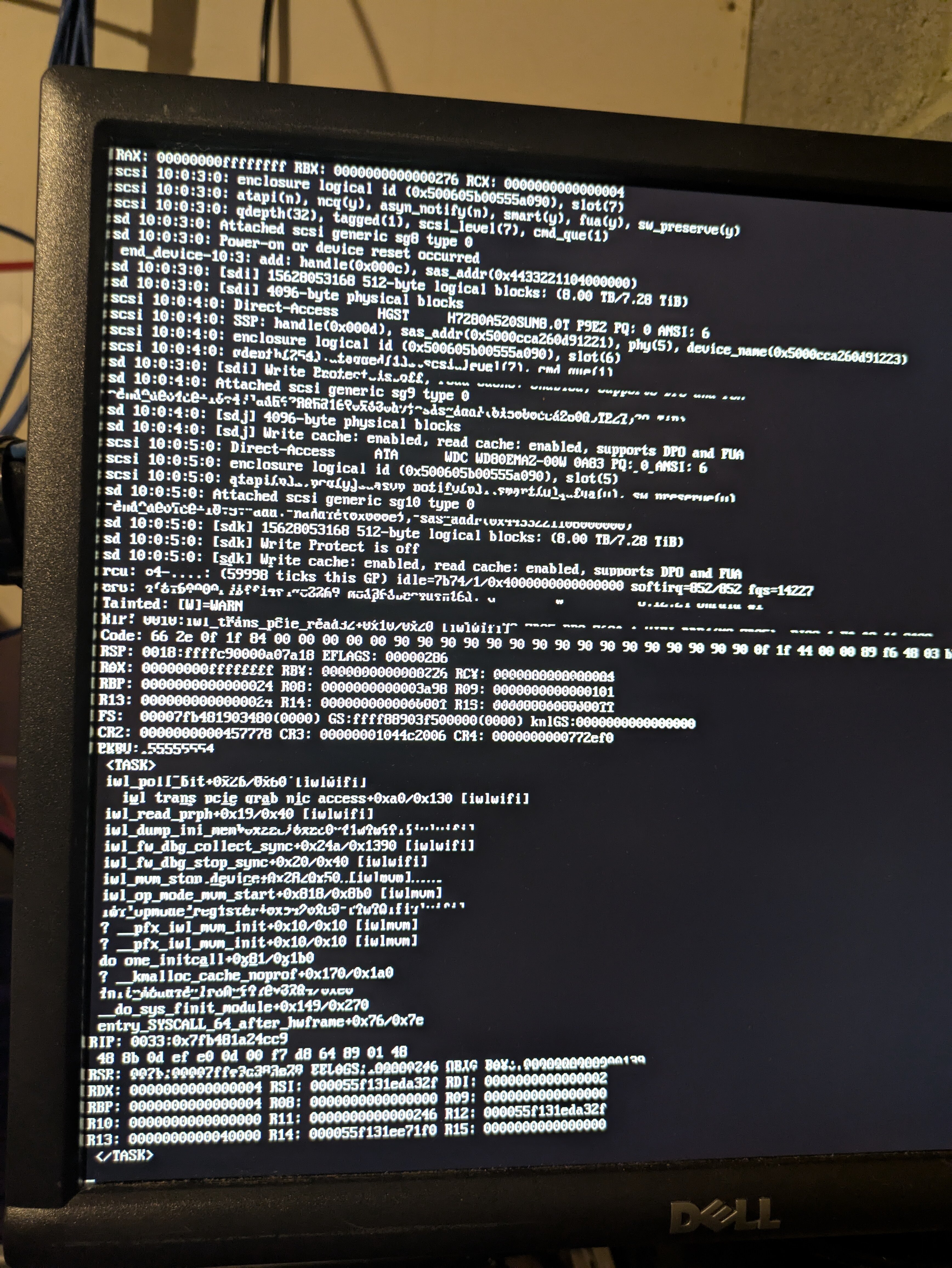

I put everything together (outside the box) and it powered up no problems, got to the mobo splash screen and set the boot drive to the USB. Saved, plugged in my unRaid USB, restarted, went back to the mobo splash screen. Tried other USB ports, no change.
1. The mobo recognizes the usb drive brandname, so it is "seeing" it, but it is not booting into unRaid
2. The mobo is set to UEFI
Any troubleshooting thoughts?

Made the folder change and it recognized the drive, however it got stuck during boot.
Got it back up. Thank you. Will open a new post for subsequent issues.
