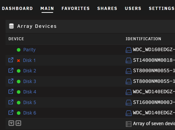

Disk 1 has been disabled again — this is the second time within roughly three weeks.
This drive is installed in an 8-disk hot-swap cage. The last time it was disabled, I moved it to a different slot in the same cage and ran a new configuration. So far, none of the other drives in the cage have had this issue.
Does this point to the drive itself failing and needing replacement, or could it still be a connection problem? I’m skeptical of a connection issue since it’s secured inside a drive cage, but I’d greatly appreciate your insights—whether that’s steps I can take to further check the drive, or confirmation that replacement is the best option.

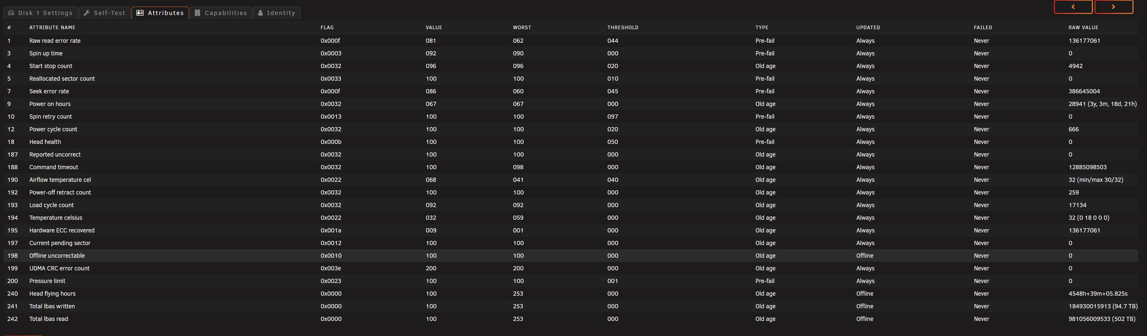

Hello, I swapped this disk into a different position last time it was disabled. The cage has 2 PCBs each control 4 disks, I also moved this disabled drive into the slot of the other PCB. and it's roughly one/two weeks after that swap, it disabled again. So that is where my fear come from. A reboot and re-connect cables do bring the drive online, but it is scary for me in this situation. Not sure if it helps, I attached the smart (this is after the reboot and re-config)

If you swapped positions and the issue followed the disk, it suggests the disk is the problem, despite the healthy SMART, note that SMART doesn't catch every type of issue.

Thank you for confirming that perspective. That makes sense. I appreciate the clarification, and I’ll move forward with preparing a replacement drive (just in case).
