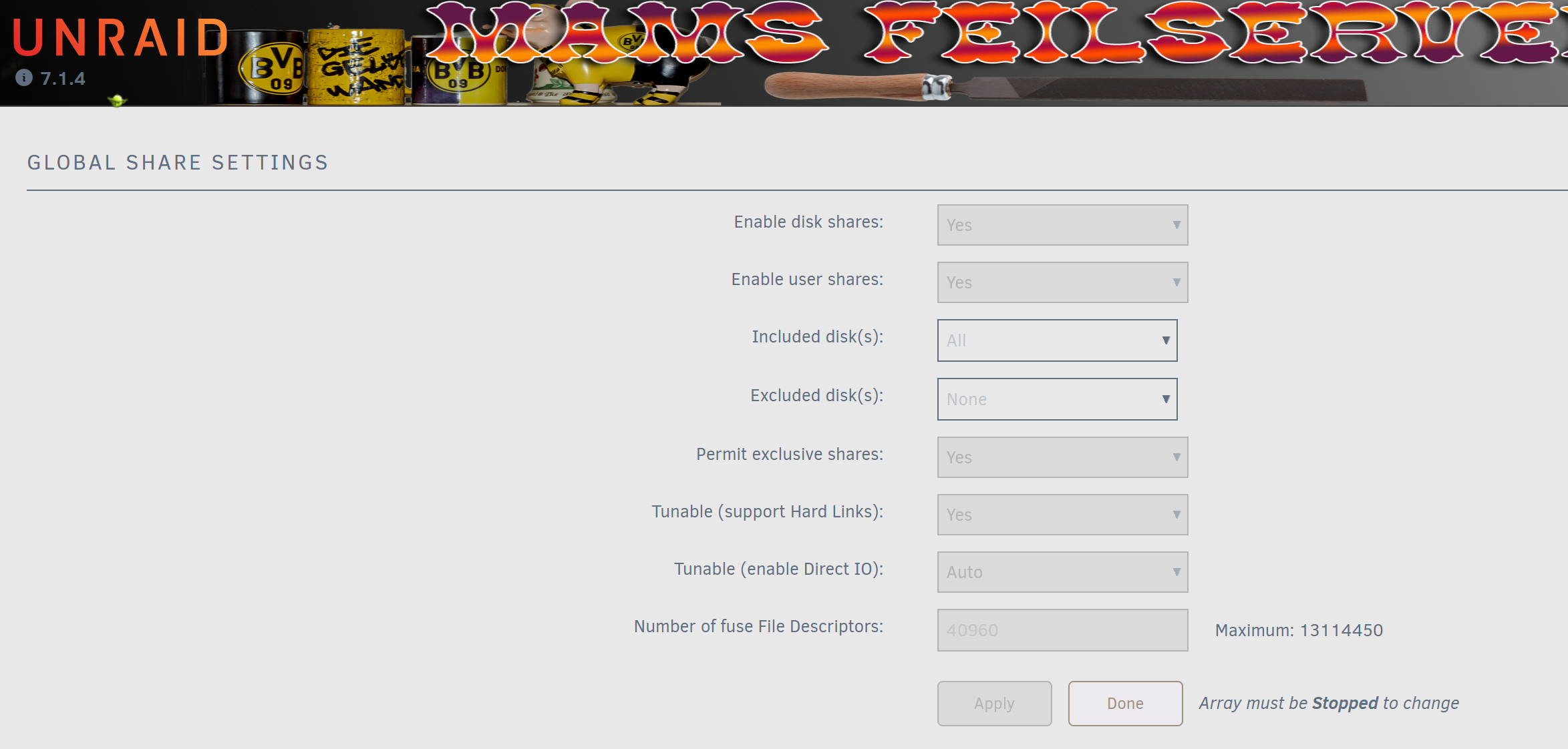

August 19, 20251 yr Community Expert you can safely enable exclusive shares / access (the term is quite misleading I think)you need to turn it on globally:Afterwards the shares that match the criteria automatically will be converted and show the hook (you can never set it directly for a share) Edited August 19, 20251 yr by MAM59
