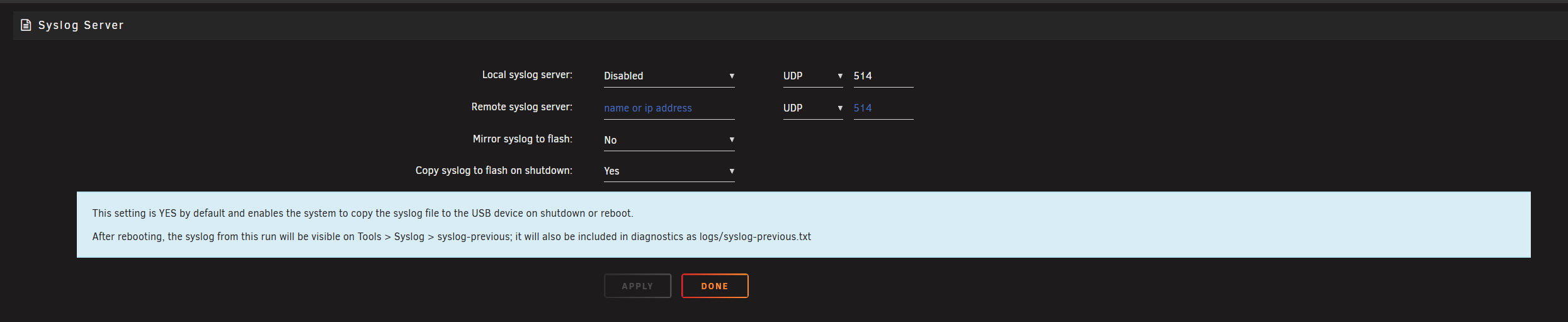

The syslog in the diagnostics is the RAM copy and only shows what happened since the reboot.   It could be worth enabling the syslog server to get a log that survives a crash/reboot so we can see what happened prior to the reboot. The mirror to flash option is the easiest to set up, but if you are worried about excessive wear on the flash drive you can put your server’s address into the Remote Server field.

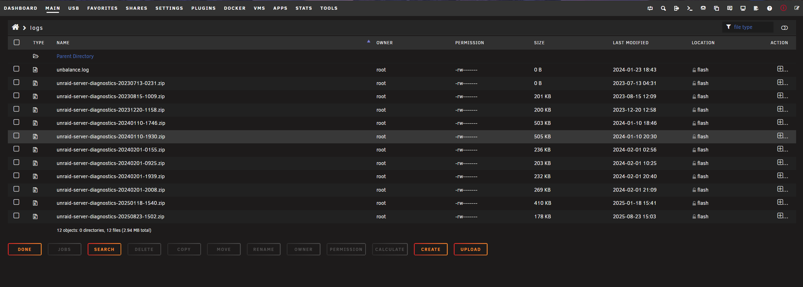

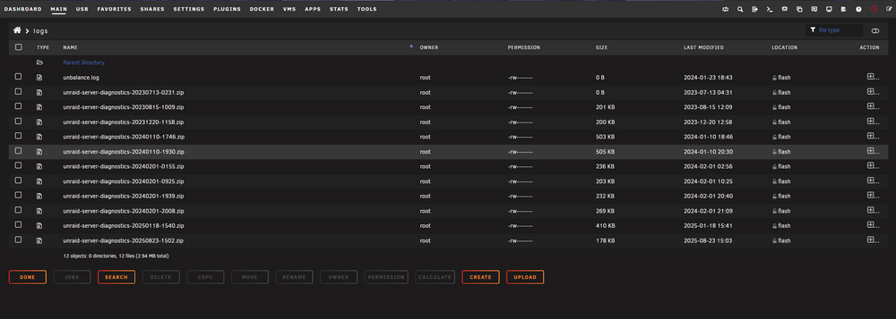

@itimpi thank you for the quick reply. I had the syslog server set to this:
But there are no logs/syslog-previous.txt for me.
And honestly, I only got the unraid server in use. There is no other server, so I don't know how to set up a remote syslog server. I know that mirroring to flash is not made to be used all the time.
Edited by sasbro97
That has only set the syslog server into ‘listen’ mode! To get it to actually start recording you either need to set the mirror to Flash option OR put your server IP address into the Remote Server field as mentioned in the link.
