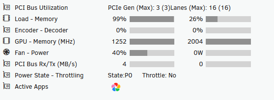

August 26, 20251 yr The whisper-asr-webservice doesn't have an official support thread, so posting here. Mods: feel free to relocate to a more appropriate forum.I've deployed the whisper-asr-webservice from the community apps as a docker container. My goal is to have it perform sub creation via Bazarr. I have Bazarr and Whisper talking, and it will generate subs, but only using my CPU.From the documentation, I needed to have the --gpus all extra parameter set. (which it is by default). But with that setting, it's still using the CPU.I've even setup the NVIDIA_VISIBLE_DEVICES and NVIDIA_VISIBLE_DEVICES variables (with the same values that I have set for my other dockers), but still uses CPU.I also added the extra parameter: --runtime=nvidia but still can't get it to use the GPUI'm sort of at a loss on what to try next. Edited August 26, 20251 yr by Xoron
August 26, 20251 yr Author So I've made some progress. I was able to get whisper-asr-webservice to see and attempt to use my GPU, but doesn't seem like it's using the decoded/encoder engine. My original problem was that when you want to use the GPU (--gpus all which is on by default), I had to use the specific repository that calls the compatible docker. onerahmet/openai-whisper-asr-webservice:latest-gpuBut now when Bazarr tries to generate subtitles for videos, it never completes it, and the GPU sits idle, all while using up loads of memory:

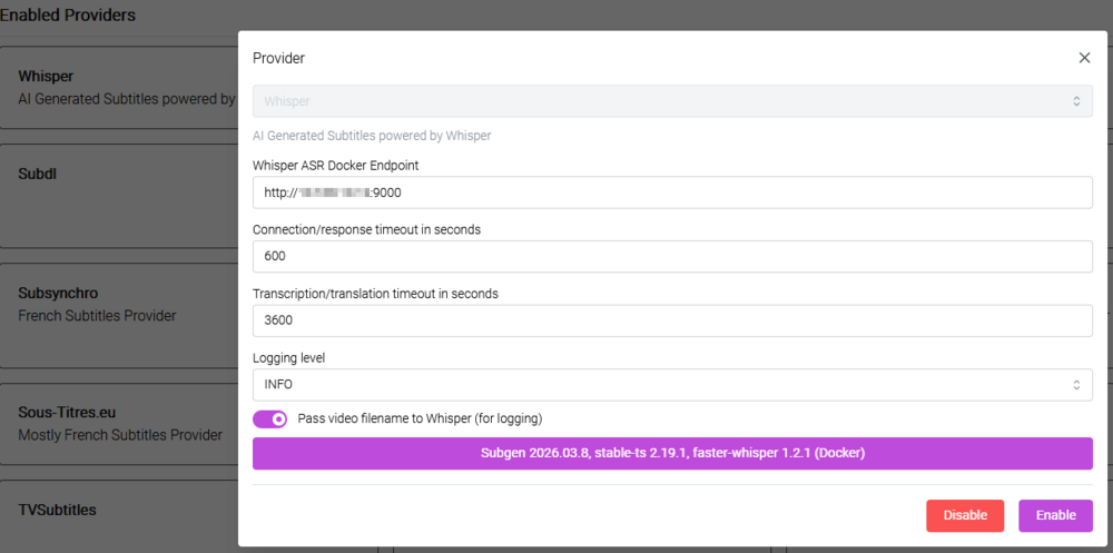

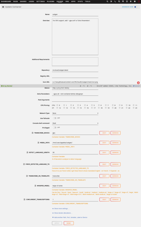

March 27Mar 27 On 3/4/2026 at 5:54 PM, Xoron said:I abandoned whisper ASR and went with subgen (https://github.com/McCloudS/subgen). And it's been working fine ever sinceYou just use whisper asr in the bazarr setup, and point it at port 9000 for subgenI've been having a hard time getting this to work and integrate with Bazarr. Would you mind sharing a screenshot of your settings? obviously censor out anything sensitive like tokens or your IP
March 27Mar 27 Author I've been having a hard time getting this to work and integrate with Bazarr. Would you mind sharing a screenshot of your settings? obviously censor out anything sensitive like tokens or your IPHope this helps.I run my subgen networking through another docker image. So that part might be different for you.
