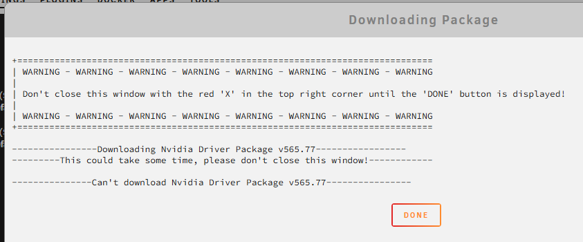

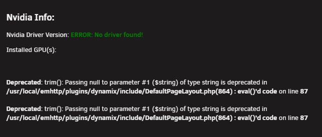

This morning, after yet another reboot, the Nvidia driver was suddenly missing, and downloading it again did not work.
At this point, the server is extremely unstable and I really don’t know what else to try.
