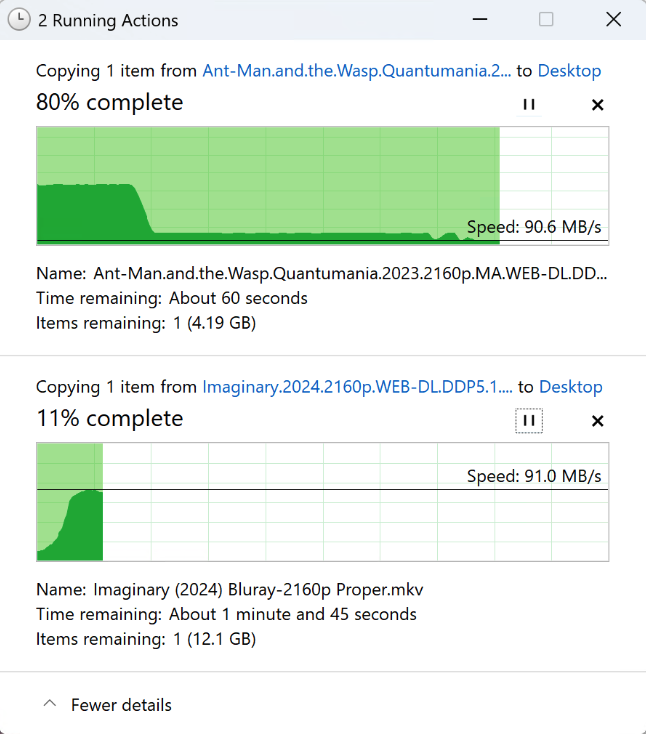

I have setup an array of 6 disks, 1 of which is a parity drive. When copying 2 single large files from the array to my windows machine I notice the speed is halved even though the files are copying from 2 different drives in the array. I have a 10Gbe network card on both ends. So I will be getting about just over 200MB/s and then as soon as i start copying another file I notice each file copies at just under 100MB/s. I would understand this if they was copying from the same drive but I thought this wouldnt be the case as they are copying from 2 different drives. Any help with this would be much appreciated.

So just tried using disk shares and got the same result.
I have added two screenshots to show the difference in speed and as I said both files are on different drives in the array.

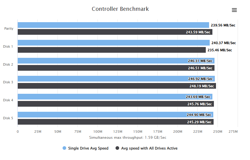

So I ran a bandwidth test using diskspeed on my controller. The rsult was "Current & Maximum Link Speed: 8GT/s (PCIe 3) width x2 (1.97 GB/s max throughput)"
Would 6x Sata 7200rpm HDD's bottleneck this?
It shouldn't, but you can run an actual controller bandwidth test with that app, where all disks are read simultaneously.
Based on the results below it does not look like the controller is the problem. Not sure what else to try to see what the isue might be
Yep, that looks fine. Please post the diagnostics so that I can look at your config to see if I can reproduce it.

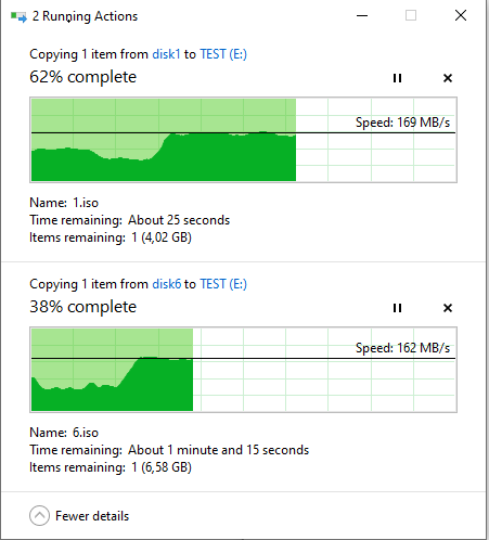

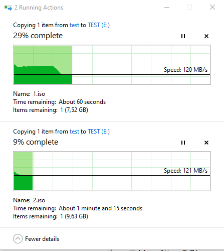

I've retested this, and basically I'm seeing the same as you: 1.iso comes from disk1, 2.iso comes from disk2:
I had reported this to LT more than a year ago, but at the time, it wasn't so noticeable in my testing with fewer devices, especially with XFS.
Tests at the time were done with SSDs and don't remember exactly how I tested, but it wasn't over SMB, so that can also play a part.
I brought this up again to LT, since it's much more noticeable in my current tests, so hopefully something can be done in the future to help with this.

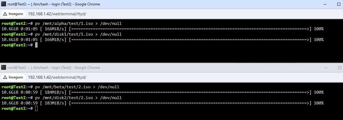

So after discussing this with LT and doing some more testing, it does look as if it may be more of an SMB issue, I see the same speed halving if I copy from two independent pools, and those don't use the md driver.

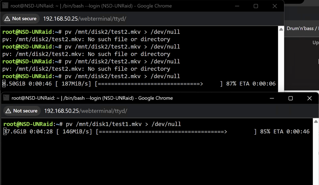

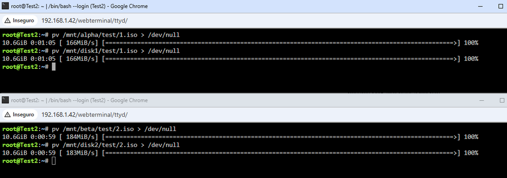

Please retest locally with pv to /dev/null like I did, to see if you get the same results.
Use a large file as source and run both copies from two different disks at the same time, I've also tested from two different pools at the same time, and it was the same:
Note that if you do multiple runs, always stop and restart the array before each run, or you will likely get bad results due to RAM caching.
P.S. Different disks were used this time, hence the different speeds.
Definetly much faster for me when running your test scenario.
Thanks for looking into this for me. I will use the web terminal whenever i need the extra speed as this seem much faster.

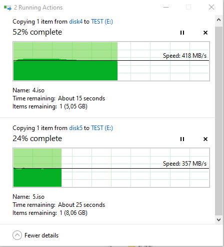

Some more findings: this is reading from two SSDs over SMB. The first copy starts at around 390MB/s, and it gets halved when starting the 2nd one:
After adding these to SMB extras in Unraid (Settings - SMB - SMB Extras)
aio read size = 1
aio write size = 1
So this appears to be the resolve the issue; please try.

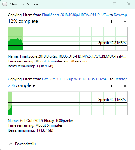

So I tried the same but for me it did not work. It seems to have slowed down copying a single file to less then 100MB/s and then just under half that when copying 2 files from different disks.
I then removed the text from SMB extras and then it speeded up again but still get half the speed when copying 2 files.

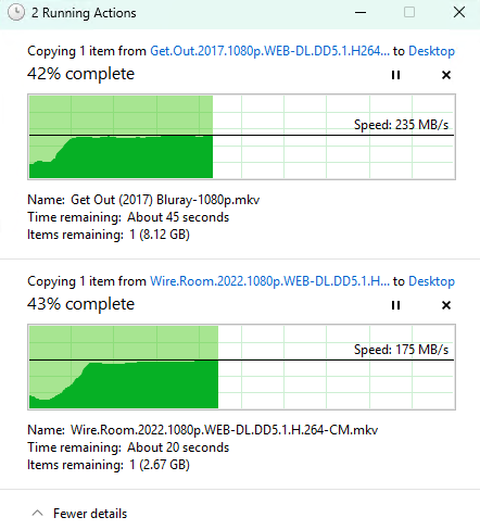

That's unexpected, but testing with HDDs instead, I also see the same: speeds are slower than without AIO, but curiously, if I pause/unpause the transfers in Windows Explorer, they do then go faster:
Very strange issue.

Same for me. I paused and then unpaused and the transfer went to normal speed. That is a very strange one!😅
