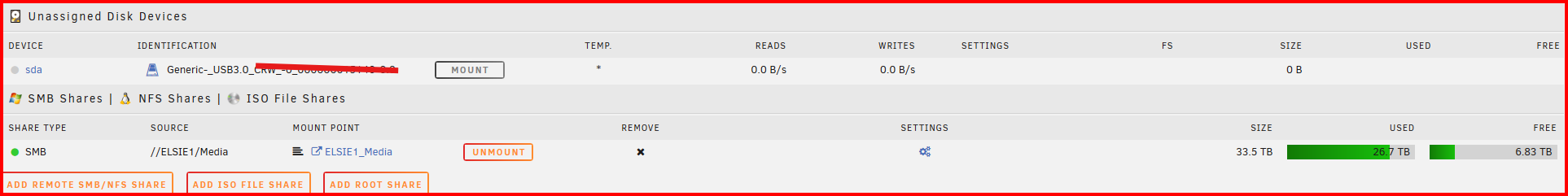

2- I setup a Unassigned Devices Share to the share on my second Unraid server:

The command is that simple. This one will copy any new or updated file from the source directories (it will recursively scan the entire directory for the source directory) to the destination directory (duplicating the source paths as required) . Notice that the source and destination are complete paths as defined on the computer from where the script is started. Rsync could care less where the source and destination are located. In this case, the source is on the remote computer and the destination is the local computer.
It can be run from the Command line in the GUI Terminal. (I have this command stored in a text file on my Windows Desktop. I use the copy-any-paste to put it into the terminal windows.) You could also use it in a BASH Shell script and run it from the terminal. (I basically used this command to move 20TB of data between my two computers when I decided I want to back up my media files. YES, it took a few days!!! TMUX-- google this for info -- is included in one of the Unassigned Devices plugins which allow you to close and resume the terminal window which means you can start the command and close the terminal and reconnect later to check the progress.)
