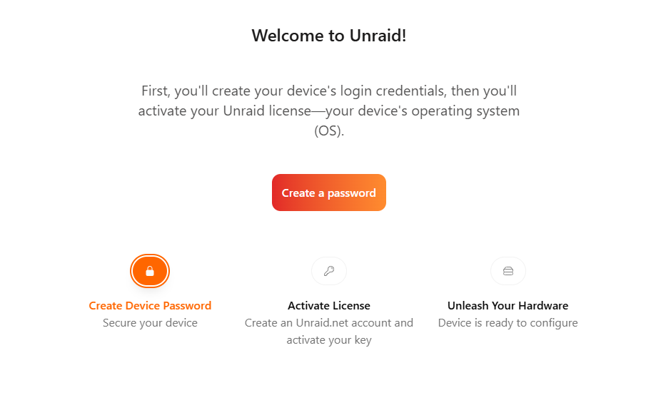

Hello, I have been running Unraid without many issues for about a year now, but ran into an interesting issue this morning. I updated the Unraid Connect plugin, while logged in using Unraid Connect, and when it refreshed, the web UI was failing to load with a "connection refused" error. I connected to my VPN to access it by IP and I was greeted with the "Welcome to Unraid!" window shown below. I cannot connect to the server using SSH to view any logs. Is it safe to go through this process and keep my configuration, or should I restore from a flash back up? Thanks for the help!
That suggests the root password config files are missing, you can try creating a new one to see if that's the only issue, if there are other settings that reverted to default, may be better to restore a backup.
