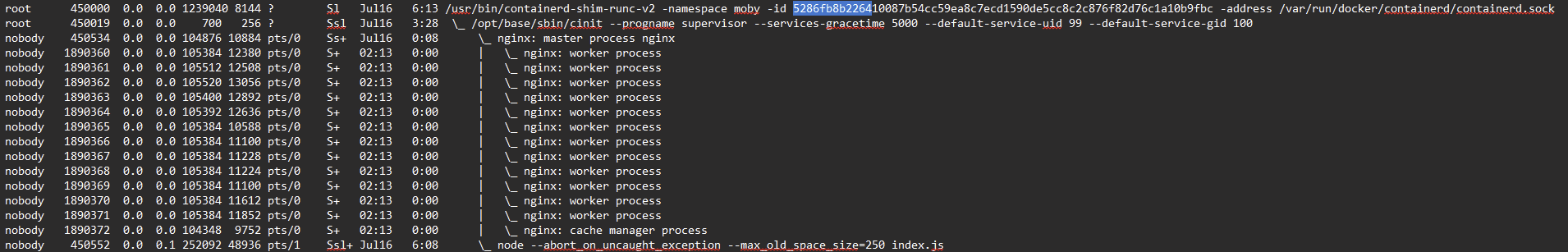

Yeah, it'd be one of your containers. In the output, the processes kicked off by the container will be listed in its hierarchy, so wherever you found that python process, follow it up to the container where you can see its ID. Then, on the docker page in unraid, switch to advanced view to show the IDs and match it up. Here's an example from my server showing what my proxy manager is running
The part I've highlighted matches the container shown in unraid
Fantastic thanks mate, looks like it was wordpress causing the issue. It was older and required and update so will update and see if it runs stable for a bit.
