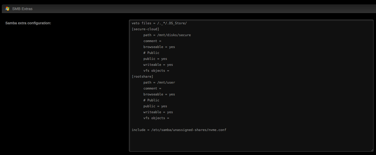

you can put it into the smb-extra tab in the gui
Note 1: the array needs to be stopped before you can edit
Note 2: you need to supply each option into a seperate line!
like
591b5a7c07d53_ScreenShot2017-05-16at20_4
these configs are saved and restored automatically after a reboot
(after edit restart the array to see the changes)
