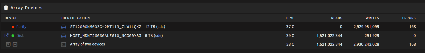

September 16, 20251 yr Hi guys, straight to the point: I purchased two used 12TB drives and wanted to replace my 6TB ones with those. I plugged in one of those, let it build parity alongside the other, but when it finished it said "Parity drive is disabled", I naively thought it was because it was executing an extended SMART test, so I cancelled it and followed some advice on this sub:- First I precleared the drive, then let it rebuild parity again, same result.- Stopped array, set parity to "no device", then started array in maintenance mode, stopped it again and reassigned the drive to parity, start and let it build parity, same result- Checked psu and sata cables, nothing wrong with them- Now I'm preclearing the other drive just to check if there's something wrong with themI'm attaching the extended SMART test and diagnostics, if someone could help me I'd appreciate it. anas-diagnostics-and-SMART.zip

October 8, 2025Oct 8 Author Officially no clue as to why this is happening, parity sync finishes with 168 errors on both disks. In the logs it says: "ANAS kernel: md: disk0 write error, sector=23437500872" a bunch of times. Does that mean BOTH drives are officially dead?I even changed SATA data cables, now I truly ran out of options! Is there anything I could do?anas-diagnostics-20251008-2212.zipPinging @JorgeB Edited October 8, 2025Oct 8 by apool

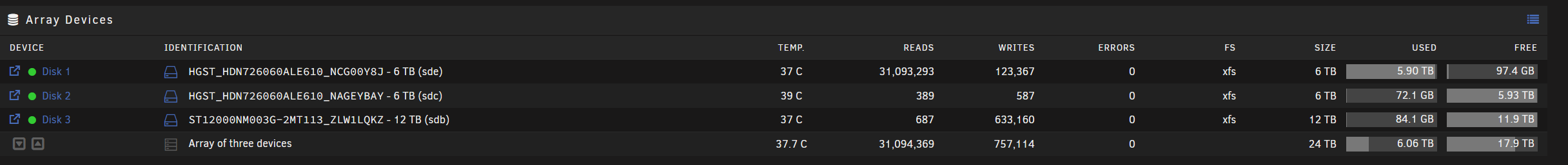

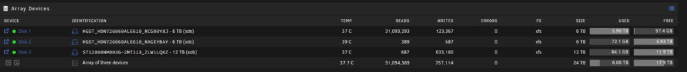

October 20, 2025Oct 20 Author Well, I haven't had any luck with these. I had a SATA to DC adapter lying around, connected it to a faulty drive and started a parity check, also gave write errors at the end of the check.What's surprising to me is that I can add these drives as data devices and it'll eat it up with no complaints:I've purchased another 12TB one, different brand, and I'll use that one as parity, but it's really strange what happened with these drives
