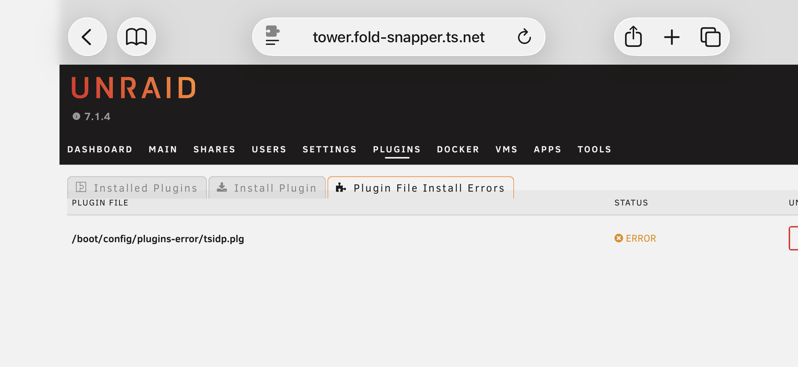

September 27, 2025Sep 27 I’m running unRAID 7.1.4.I installed Plugin Diagnostics, and attached the zip.I did notice the following error is being logged… Tower-tsidp-diag-20250927-172329.zip
September 28, 2025Sep 28 Author 13 hours ago, DeltaEchoFour said:Love this plugin!!! But, it seems to not persist a reboot… anything I can try??Thanks!!I just released an update that should fix that problem.

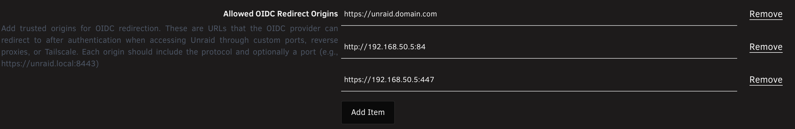

September 30, 2025Sep 30 3 hours ago, EDACerton said:I just released a new update, it has an "allowed hosts" setting on the Tailscale IDP settings page. Add anything you need there (separated by spaces)Just tested that - looks like it's appending the same ports to my domain as I use for non-reverse proxy access. So I have :84 and :447 set as HTTP and HTTPS WebGUI in Unraid, but when I add unraid.domain.com, it's adding it as https://unraid.domain.com:447/graphql... where my reverse proxy doesn't need the port. It also doesn't seem to like IP's, I tried adding 192.168.50.5 and it didn't add anything to the IDP. (I tried it with a space after the first entry and also just on it's own in the Allowed Hosts field) - maybe if it was a field that doesn't append ports, tooltip could be to add the host:port and then the plugin is only appending /graphql/api..., for me that would be "unraid.domain.com 192.168.50.5:84 192.168.50.5:447"I don't know enough about the Unraid API, but could it reference the entries from "Allowed OIDC Redirect Origins"
October 1, 2025Oct 1 Author 19 hours ago, erf89 said:Just tested that - looks like it's appending the same ports to my domain as I use for non-reverse proxy access. So I have :84 and :447 set as HTTP and HTTPS WebGUI in Unraid, but when I add unraid.domain.com, it's adding it as https://unraid.domain.com:447/graphql... where my reverse proxy doesn't need the port. It also doesn't seem to like IP's, I tried adding 192.168.50.5 and it didn't add anything to the IDP. (I tried it with a space after the first entry and also just on it's own in the Allowed Hosts field) - maybe if it was a field that doesn't append ports, tooltip could be to add the host:port and then the plugin is only appending /graphql/api..., for me that would be "unraid.domain.com 192.168.50.5:84 192.168.50.5:447"I don't know enough about the Unraid API, but could it reference the entries from "Allowed OIDC Redirect Origins"Possibly, I'll have to dig into that more.In the meantime, I adjusted the setting in "Tailscale IDP" -- if an entry starts with http:// or https://, it won't try to add the WebGUI port.
October 1, 2025Oct 1 4 hours ago, EDACerton said:Possibly, I'll have to dig into that more.In the meantime, I adjusted the setting in "Tailscale IDP" -- if an entry starts with http:// or https://, it won't try to add the WebGUI port.Ahh this is great, just tested and all working, thanks! Great project this, I was testing it out with Tinyauth the other day to SSO apps that don't have OIDC

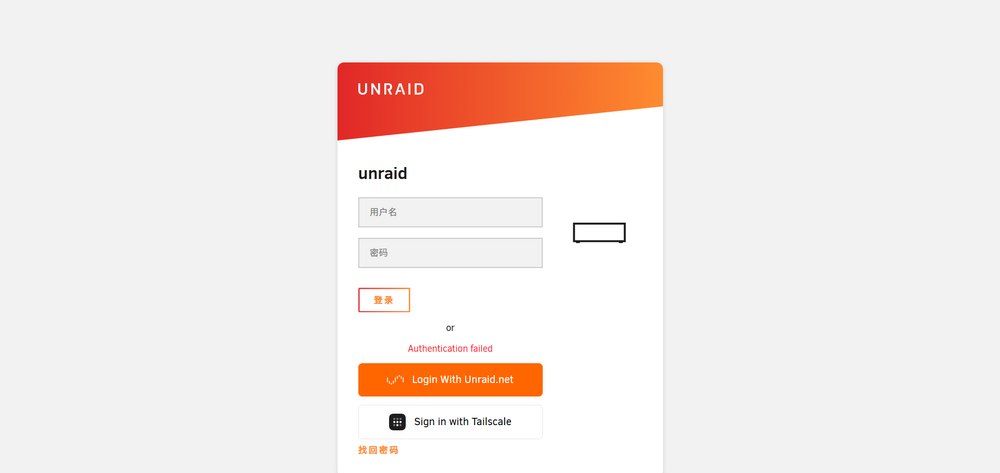

November 8, 2025Nov 8 When logging in it adds the port 1025 to the tailscale serve url with this error: Error 400: invalid_request - redirect_uri mismatch Edited November 8, 2025Nov 8 by PilaScat

April 27Apr 27 [07:04:39 INFO OidcService]: Built authorization URL via discovery for provider tsidp {"apiVersion":"4.29.2+c39b0b26","logger":"OidcService","context":"OidcService"} [07:04:39 INFO OidcService]: Authorization parameters: {"redirect_uri":"https://unraid.xxx.ts.net/graphql/api/auth/oidc/callback","scope":"openid profile email","state":"tsidp:bc1d80521bfc123745e5acb35ad74372.1777275939026.07cd4c720601451f09277a0d0b828830a14d12493d7369346938e1d91599ece9","response_type":"code"} {"apiVersion":"4.29.2+c39b0b26","logger":"OidcService","context":"OidcService"} [07:04:39 INFO OidcRestController]: Redirecting to OIDC provider: https://unraid.xxx.ts.net:1025/authorize?redirect_uri=https%3A%2F%2Funraid.xxx.ts.net%2Fgraphql%2Fapi%2Fauth%2Foidc%2Fcallback&scope=openid+profile+email&state=tsidp%3Abc1d80521bfc123745e5acb35ad74372.1777275939026.07cd4c720601451f09277a0d0b828830a14d12493d7369346938e1d91599ece9&response_type=code&client_id=unraidgui {"apiVersion":"4.29.2+c39b0b26","logger":"OidcRestController","context":"OidcRestController"} [07:04:39 ERROR OidcTokenExchangeService]: Token exchange failed {"apiVersion":"4.29.2+c39b0b26","logger":"OidcTokenExchangeService","context":"OidcTokenExchangeService"} [07:04:39 ERROR OidcTokenExchangeService]: Error type: ClientError {"apiVersion":"4.29.2+c39b0b26","logger":"OidcTokenExchangeService","context":"OidcTokenExchangeService"} [07:04:39 ERROR OidcTokenExchangeService]: Error message: unexpected response content-type {"apiVersion":"4.29.2+c39b0b26","logger":"OidcTokenExchangeService","context":"OidcTokenExchangeService"} [07:04:39 ERROR OidcTokenExchangeService]: Error code: OAUTH_RESPONSE_IS_NOT_JSON {"apiVersion":"4.29.2+c39b0b26","logger":"OidcTokenExchangeService","context":"OidcTokenExchangeService"} [07:04:39 ERROR OidcTokenExchangeService]: Error cause chain: {"apiVersion":"4.29.2+c39b0b26","logger":"OidcTokenExchangeService","context":"OidcTokenExchangeService"} [07:04:39 ERROR OidcTokenExchangeService]: [Cause 1] object: [object Response] {"apiVersion":"4.29.2+c39b0b26","logger":"OidcTokenExchangeService","context":"OidcTokenExchangeService"} [07:04:39 ERROR OidcTokenExchangeService]: Token endpoint returned invalid or non-JSON response. {"apiVersion":"4.29.2+c39b0b26","logger":"OidcTokenExchangeService","context":"OidcTokenExchangeService"} [07:04:39 ERROR OidcTokenExchangeService]: This typically means: {"apiVersion":"4.29.2+c39b0b26","logger":"OidcTokenExchangeService","context":"OidcTokenExchangeService"} [07:04:39 ERROR OidcTokenExchangeService]: 1. The token endpoint URL is incorrect (check for typos or wrong paths) {"apiVersion":"4.29.2+c39b0b26","logger":"OidcTokenExchangeService","context":"OidcTokenExchangeService"} [07:04:39 ERROR OidcTokenExchangeService]: 2. The server returned an HTML error page instead of JSON {"apiVersion":"4.29.2+c39b0b26","logger":"OidcTokenExchangeService","context":"OidcTokenExchangeService"} [07:04:39 ERROR OidcTokenExchangeService]: 3. Authentication failed (invalid client_id or client_secret) {"apiVersion":"4.29.2+c39b0b26","logger":"OidcTokenExchangeService","context":"OidcTokenExchangeService"} [07:04:39 ERROR OidcTokenExchangeService]: 4. A proxy/firewall is intercepting the request {"apiVersion":"4.29.2+c39b0b26","logger":"OidcTokenExchangeService","context":"OidcTokenExchangeService"} [07:04:39 ERROR OidcTokenExchangeService]: 5. The OAuth server returned malformed JSON {"apiVersion":"4.29.2+c39b0b26","logger":"OidcTokenExchangeService","context":"OidcTokenExchangeService"} [07:04:39 ERROR OidcTokenExchangeService]: Configured token endpoint: https://unraid.xxx.ts.net:1025/token {"apiVersion":"4.29.2+c39b0b26","logger":"OidcTokenExchangeService","context":"OidcTokenExchangeService"} [07:04:39 ERROR OidcTokenExchangeService]: Please verify your OIDC provider configuration. {"apiVersion":"4.29.2+c39b0b26","logger":"OidcTokenExchangeService","context":"OidcTokenExchangeService"} [07:04:39 ERROR OidcService]: OAuth callback error: unexpected response content-type {"apiVersion":"4.29.2+c39b0b26","logger":"OidcService","context":"OidcService"} [07:04:39 ERROR OidcRestController]: OIDC callback error: UnauthorizedException: Authentication failed {"apiVersion":"4.29.2+c39b0b26","logger":"OidcRestController","context":"OidcRestController"}Tailscale ACL below:{ "src": ["tag:grp-admin", "tag:role-relay"], "dst": ["*"], "ip": ["*"], "app": { "tailscale.com/cap/tsidp": [ { "allow_admin_ui": true, "allow_dcr": true, "resources": ["*"], "users": ["*"], }, ], }, }
