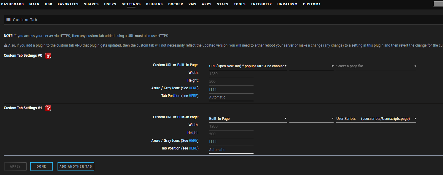

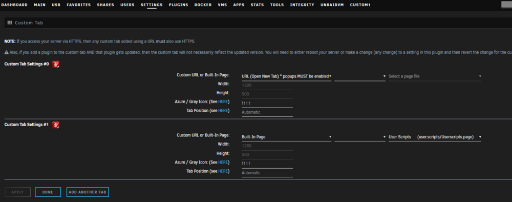

  10. Not sure if this is a bug when using in 7.0.0-rc1, but I can no longer see the Tab Name or URL options. I had an existing tab setup so that is preserved, but my tab for User Scripts I just created is called Custom1 and I can't seem to rename it
