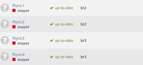

September 21, 2025Sep 21 I run 3 servers on a weakly bases. Since I find myself changing the disk configurations 1-2 times a year, and must recopy all the data from one server to another, I am looking for the fastest syncspeed from kjell to egon.kjell: 24-7, relativly low power, media/backup/vm/containers2 x 25G nics10 x sata ssd 8GBhelmaxx: Runs once a week. secon version of media library/Game VM/transcodingegon: A Truenas server simce the Exos 2x18 do not work well with Unraid. Mostly backupserver. 4 x 10Gb nics. 8 x Exox2x18 (each disk runs at about 500 Gb eachSwitch is USW EnterpriseXG 24.I have been playing around with 4 different Freefilesync container on the Unraid to sync thru each 10Gb nic on the TN server. I believ I have worn down an AI server rack, so now searching for human feedback. To my understanding this is mainly a network question,Happy for any feedback.

September 24, 2025Sep 24 Author According to ChatGPT:Source:Taking ZFS overhead and RAIDZ math into account:👉 ~4.5–5.0 GB/s sustained read is realistic from lageret(with bursts higher if ARC/L2ARC is actively serving)Destination:Your xxxx pool, with 8 mirrored vdevs from 8 Exos 2×18 dual-actuator disks, should sustain:👉 ~3.2–3.6 GB/s real-world write speed👉 Up to ~4.0 GB/s in ideal conditionsThe Unraid server has E810 nic / 2 x 25Gb, to switch 2 x 25Gb to source Truenas 4 x 10Gb nics, I´m aiming at 3 GB/s, running 4 simultaneously Freefilesync containers, I have worn out a ChatGPT serverpark, so its time to call in the experts on how to set up best possible. A key question is: “How to get the FFsync containers to utilize a specific nic? Currently enabled bridge mode for eth2/eth3, wonder if custom network type is the way to go?

September 25, 2025Sep 25 What up does iperf server to server say?What does one ffsync alone with large files achieve?I can't think of an easy way to dedicate a nic to a docker unless they're on different networks. I still suspect multiple parallel writes will hit limits due to head movements required. The above two bits for info may help isolate what's holding things back.
