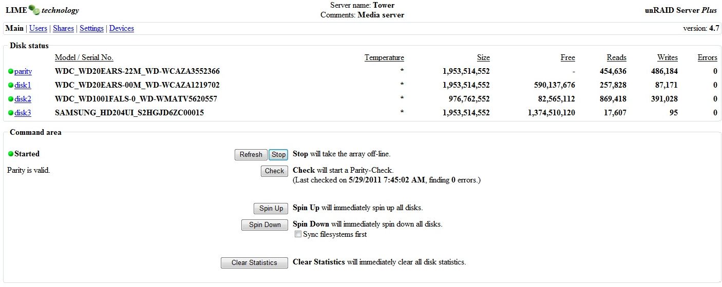

Here is my disk status before the upgrade (from 4.7)
The recent Parity Check came back fine.
Thanks Mark
