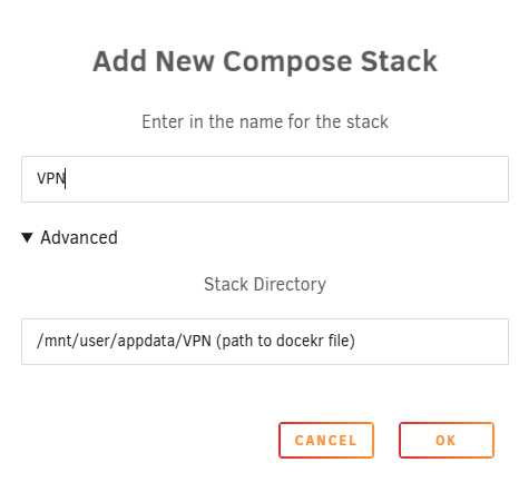

When dealing with vpn docker on unraid Prefer to use docker copoase
Docker Compose (example) to go over and reveiw...

This creates a dedicated user bridge appnet (172.23.0.0/24) and pins a couple of “via-VPN” app IPs so we can match them.
  • All 3 are on the same Docker bridge → they can reach each other by container name/IP.
  • Only the IPs you list (e.g., 172.23.0.10, .11) will be policy-routed out wg0.
If you already have a bridge you like, reuse it — just choose static IPs from that subnet for the “over-VPN” containers.

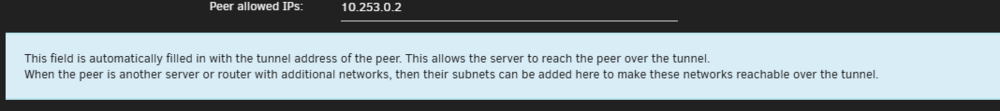

Double-check your Wiregurad unraid host settings:
My understanding is that your using urnaid vpn manger for your wire guard VPN
WireGuard & host routing glue
A. Make sure WireGuard can NAT out
If you used Unraid’s WG “Remote access to server” or similar, it likely added MASQUERADE already. If not, we’ll add it in our script below.
If your /etc/wireguard/wg0.conf is managed by Unraid, don’t hand-edit it. We’ll add rules at array start using the User Scripts plugin so they persist.

  • In your WireGuard tunnel, turn OFF “VPN tunneled access for docker.”
    That mode installs its own fwmark/table 51820 rules (you can see fwmark 0xca6c in your ip rule dump) and will fight our policy routing. We’ll do the container selection ourselves.
  • Make sure the wg interface you’re using (wg1) is up and the peer allows 0.0.0.0/0 (or at least the destinations you expect) in AllowedIPs, with NAT enabled on the peer side if needed. If the peer doesn’t route 0.0.0.0/0, adding a “default dev wg1” in table 51820 won’t actually get you to the Internet.

Requires the command ran any time the docker that's connected to goes down... the ip table's command I gave above is constant once setup... doesn't require interactions or running xyz command for other dockers...
https://bmartino1.weebly.com/guide-dockernetworks.html
OR you can use Docker compose to set 2 networks at once...
The network assignments created in my previous post persist after bringing individual containers down/up, shutting down all containers associated with the "shared network", and even after disabling/enabling docker entirely. Just for anyone's future reference.
