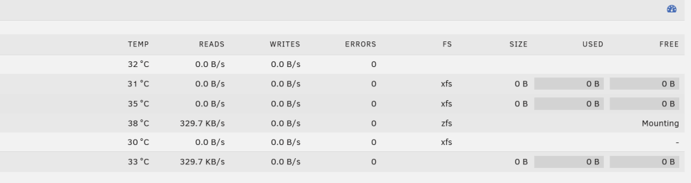

Just reviving an old thread because it seems like an issue related to this drive. The UDMA CRC error count on this array disk is still 8 and Reallocated sector 5. There's also another 3.5" drive with just a Reallocated sector 5 error only.
On the main page I'm finding the disks are not displaying stats correctly and at one point all drives completely disappeared. I've deleted browser cache and tried different browsers but the issue still persists. Shutdown server and replaced the SATA cable for the drive with the UDMA CRC error count and reseated all SATA cables and power cables for other drives. I've attached a screenshot of what's now happening after this reboot. Any advice would be much appreciated.
Edited by unraid20
Deleting a bunch of dynamix plugins seems to have solved the problem!
