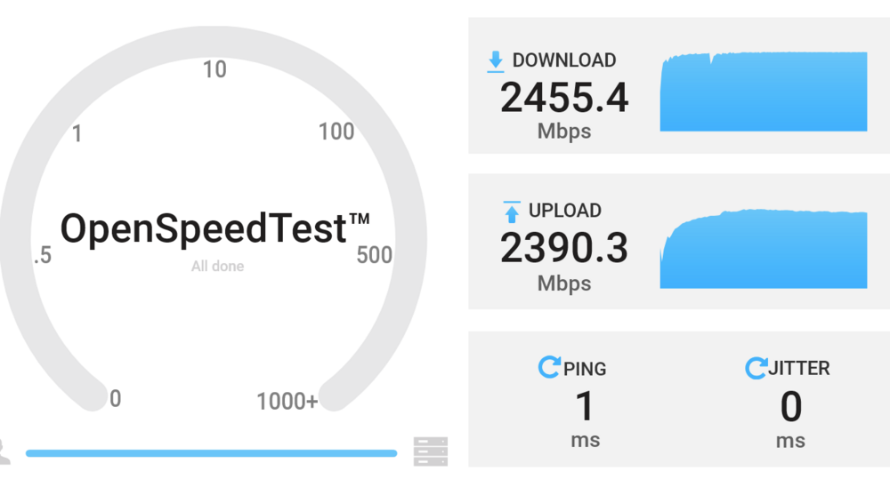

October 13, 20251 yr i-226-V works fine. Unraid has driver already in base installation.From my desktop (Realtek on MB, a little flaky) to my server (i226 on MB):

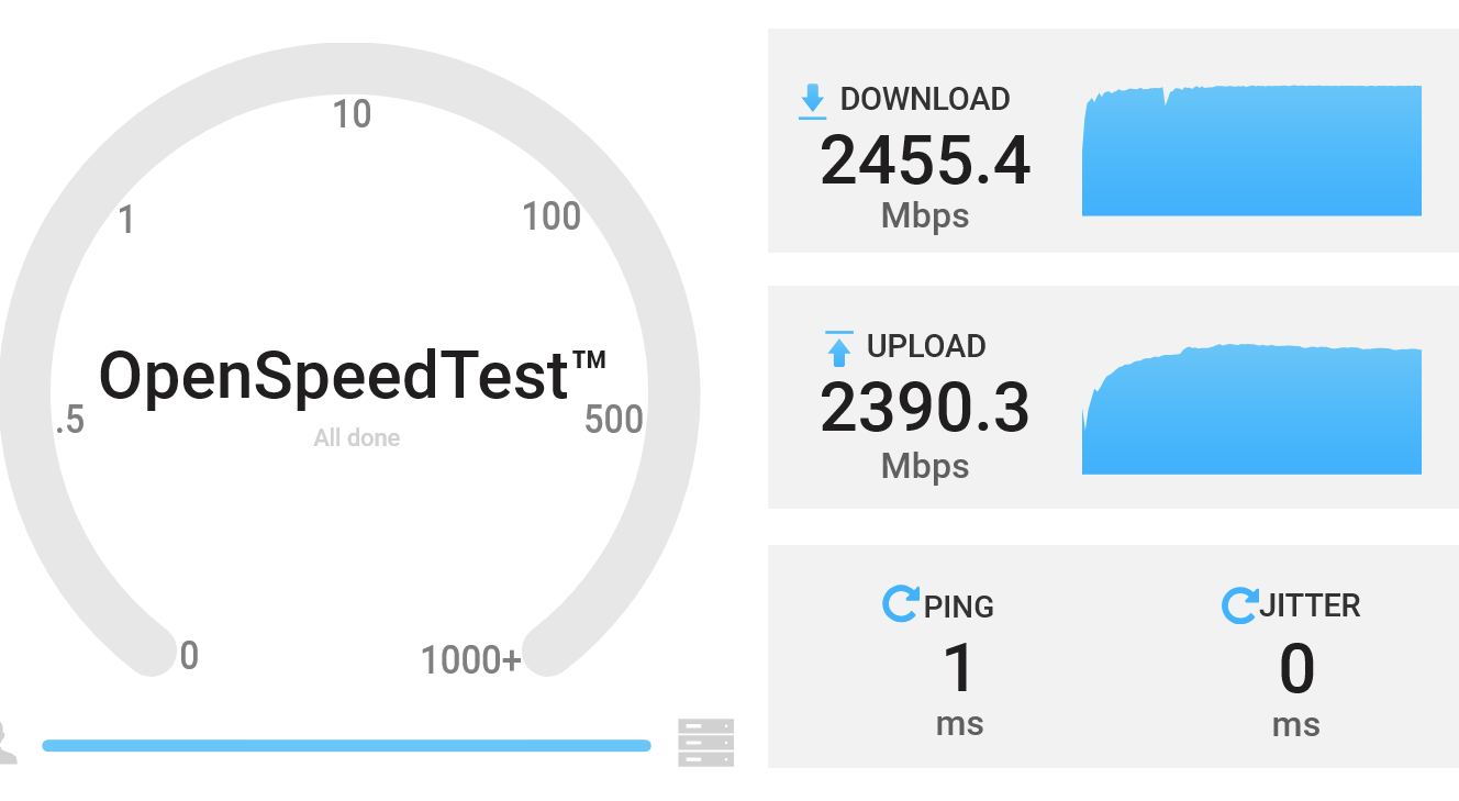

October 21, 2025Oct 21 Author I ended up getting an old "Marvell AQC107s 10Gb Network Card" used on eBay. Smooth sailing and fully supported on my ancient server. It steps down to 2.5g nicely, and I guess I've future-proofed my network. Also, pro-tip, if things aren't working out networking-wise for you, it's always smart to check your ethernet cable. Would have saved me about 2hrs of Internet research when I was getting 100Mb speeds on my Marvell card. Ended up being a bad cable. Ha.
