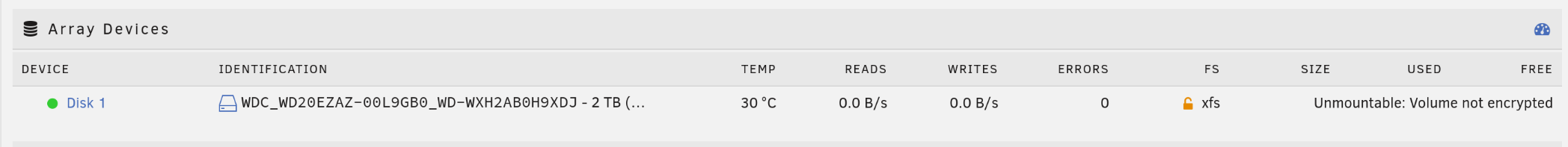

This does not work. I want the drive to have one partion which is XFS encrypted with keyfile. But every time I start formating it says at the end: umountable. Volume not encrypted.
I am lost here.
That suggests the key is missing, do you have a script or something deleting it? If not, reboot, try formatting the disk, and post the diagnostics.
The missing keyfile was a good hint. It is not sufficient to give the keyfile in the GUI (select a local file, like when first set it up). I needed to copy the keyfile manually to /root/keyfile. It works now. But is that a bug? It should be possible to provide the keyfile via GUI.
It should be, unless something is deleting it after the array starts.
