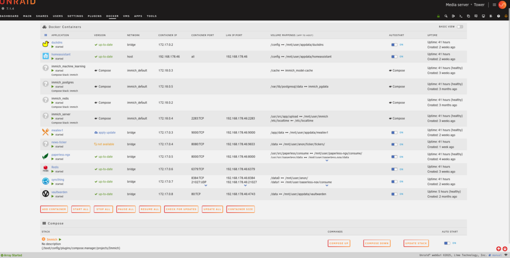

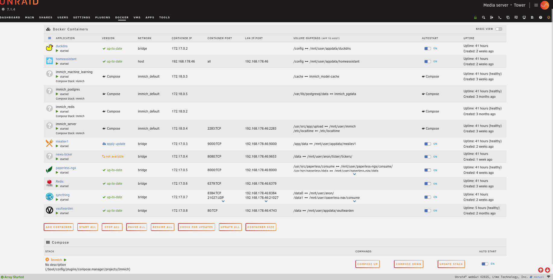

Docker service appears to be running; please post a screenshot from the Docker page.
Hey, thanks for the answer. Yes when I restart the server, everything is fine for a while. Which is what I did because the diagnostic just opened a white window before.
