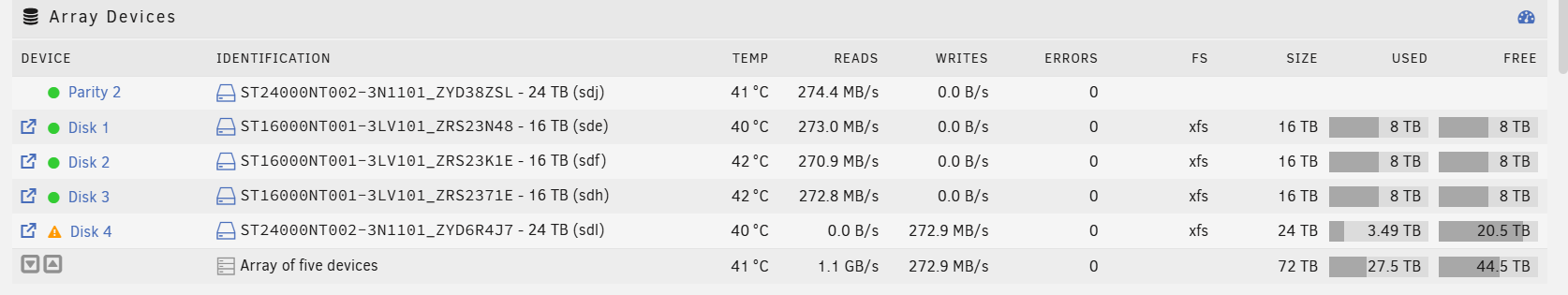

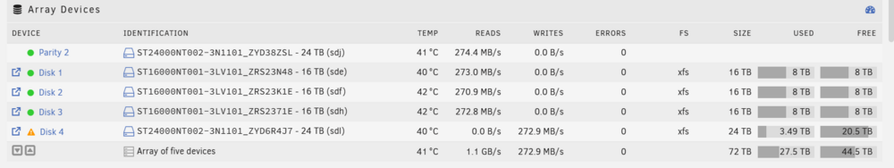

I selected Disk 4 because it had the least content on it.
So now the rebuild process is going. Will it take the amount of time to copy and rebuild the 3.49 TB of data, or the amount of time to copy 24T of mostly empty drive?

13 minutes ago, timg11 said:
I performed a Parity check, which took the amount of time to read a 24T drive, even though the Parity drive was the only drive with more than 16T capacity .
This is normal.
It will rebuild the whole drive (24TB)
