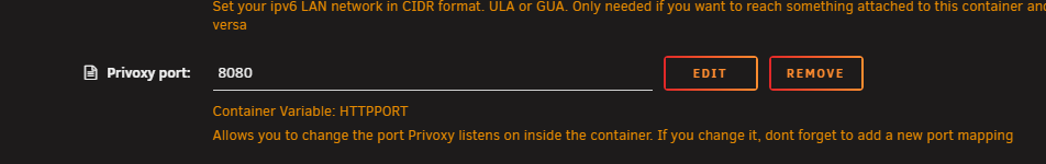

i see why, 8080 is "blocked/already used" by privoxy and the gui runs on 8080.
You can change the privoxy port by changing this variable
I tried to change the port in either one but said web gui stays unreachable. I'm looking right now into it again to see if I have not goofed a port or something.

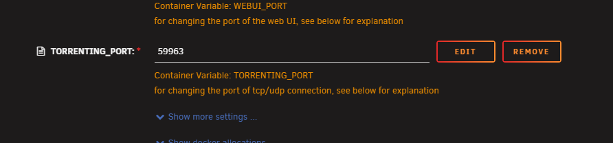

@Mainfrezzer Well looks like I did an error on my side yesterday and got the web gui worked (forgot to change the related setting/port within the qbittorent webgui itself). How do I pass the needed port from the wireguard client toward qbitorrent?
Edited by InternetD
they share the same "interface", every port that you map to the wireguard container goes also to the qbittorent container. So if you run something on 5023/tcp, you map that to the wireguard client and it will reach the attached qbittorrent container, same with 38282/udp for example, for lan that is. Same for the vpn connection, everything that hits the wireguard ip of the container, hits qbittorrent aswell, if its listening on that port, no template modification needed
Edited by Mainfrezzer
20 minutes ago, Mainfrezzer said:
they share the same "interface", every port that you map to the wireguard container goes also to the qbittorent container. So if you run something on 5023/tcp, you map that to the wireguard client and it will reach the attached qbittorrent container, same with 38282/udp for example, for lan that is. Same for the vpn connection, everything that hits the wireguard ip of the container, hits sonar aswell, if its listening on that port.

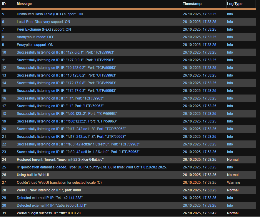

Wel it doesnt seem that ports on the tunnel can reach the qbitorrent docker. My VPN provider gives me port 59963 UDP and TCP but I cant get it through to qbitorrent.
You might have to set the variable in the qBittorrent template for the incoming port
Torrenting isnt my strong expertise but it should work absolutely fine from the logs as its binding properly to the wireguard interface ip (10.123.0.2 and fc00:123::2), as long as your provider does forward it to your client.
