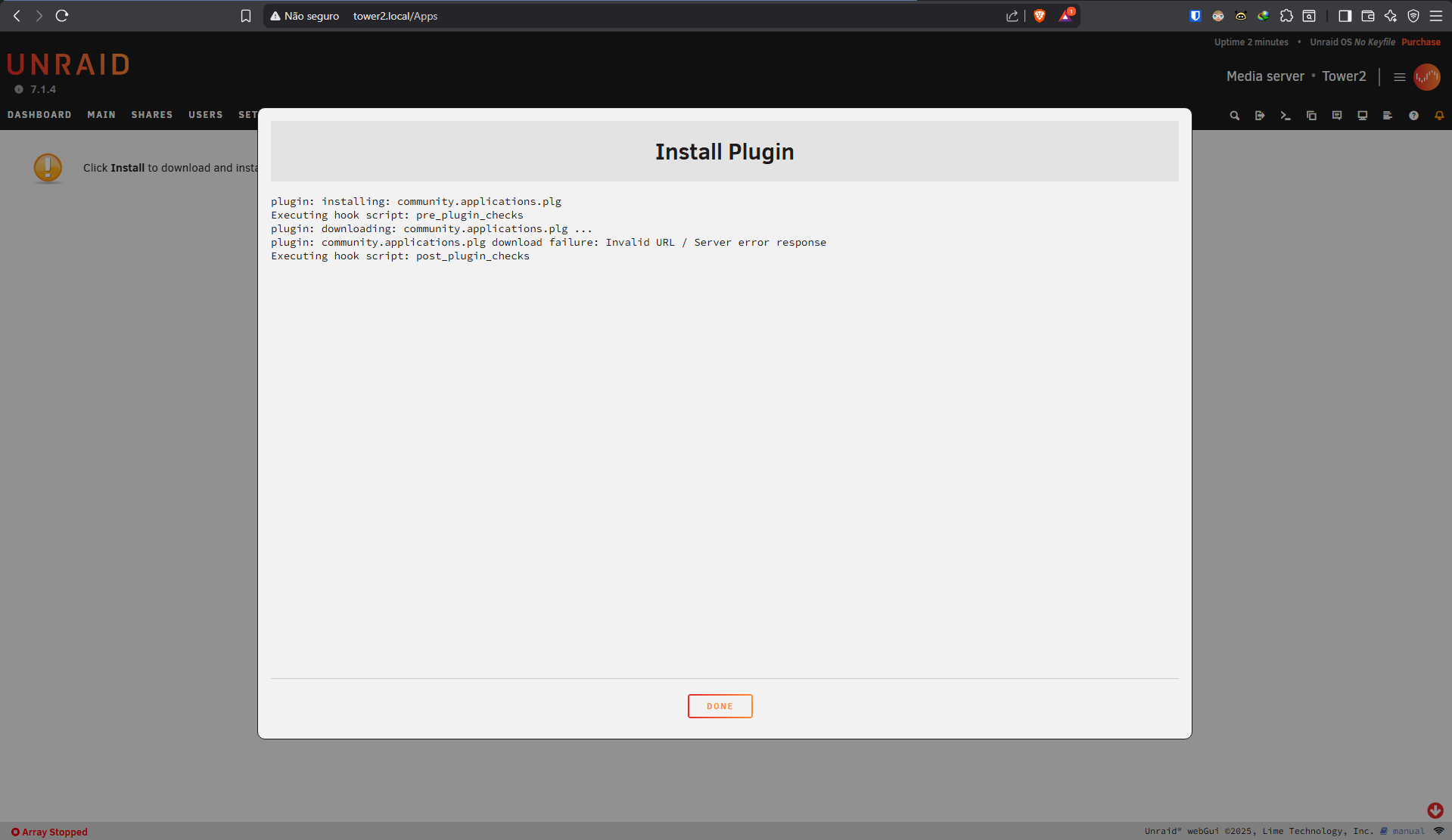

Been browsing the forum for a while and failed to do any progress.
Geting this error when trying to install community apps.
plugin: installing: community.applications.plg
Executing hook script: pre_plugin_checks
plugin: downloading: community.applications.plg ...
plugin: community.applications.plg download failure: Invalid URL / Server error response
Executing hook script: post_plugin_checks

That suggests a network problem, but to rule out a config issue, you can boot with a new flash drive using a stock install, no key needed, then see if APPS works correctly.
I was facing the same issue earlier today - are you from Brazil by any chance? If so, this might be happening because the community plugins install script is downloaded as a raw file from github, and lately some LatAM have been having some issues with rate limited requests that are preventing these from working.
As a workaround, you could setup a VPN to another country (I suggest Canada as I'm using that on Proton VPN without issues), that should be enough for the script to work.

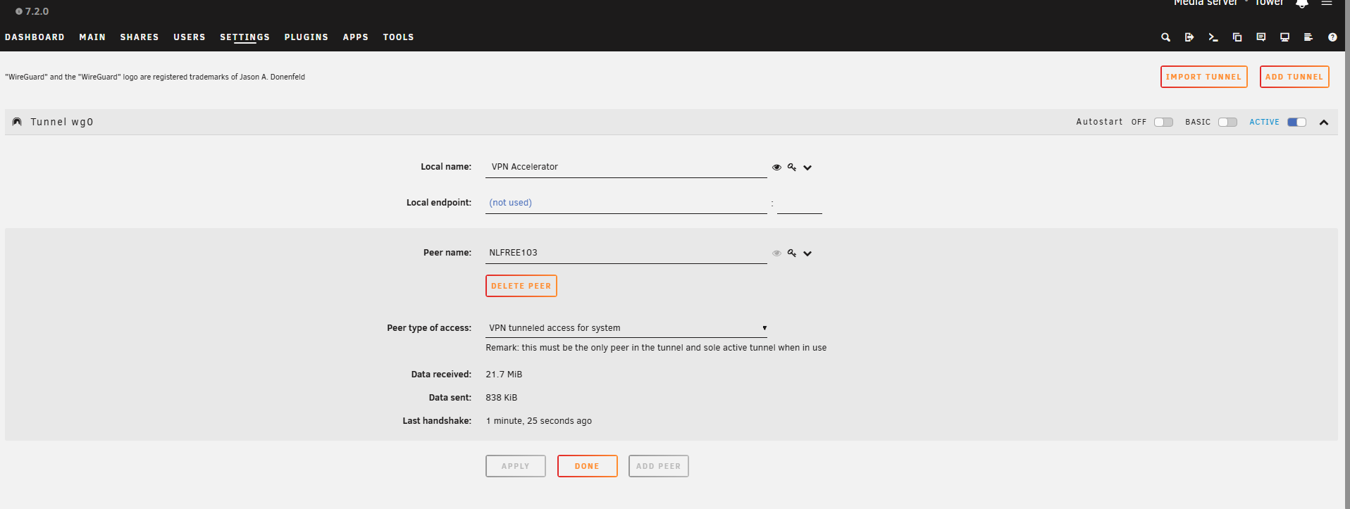

Dear lord.. It did work with Proton VPN and Wireguard. managed to install Community apps and other stuff.
I have no idea what i have done and even if this is secure.
