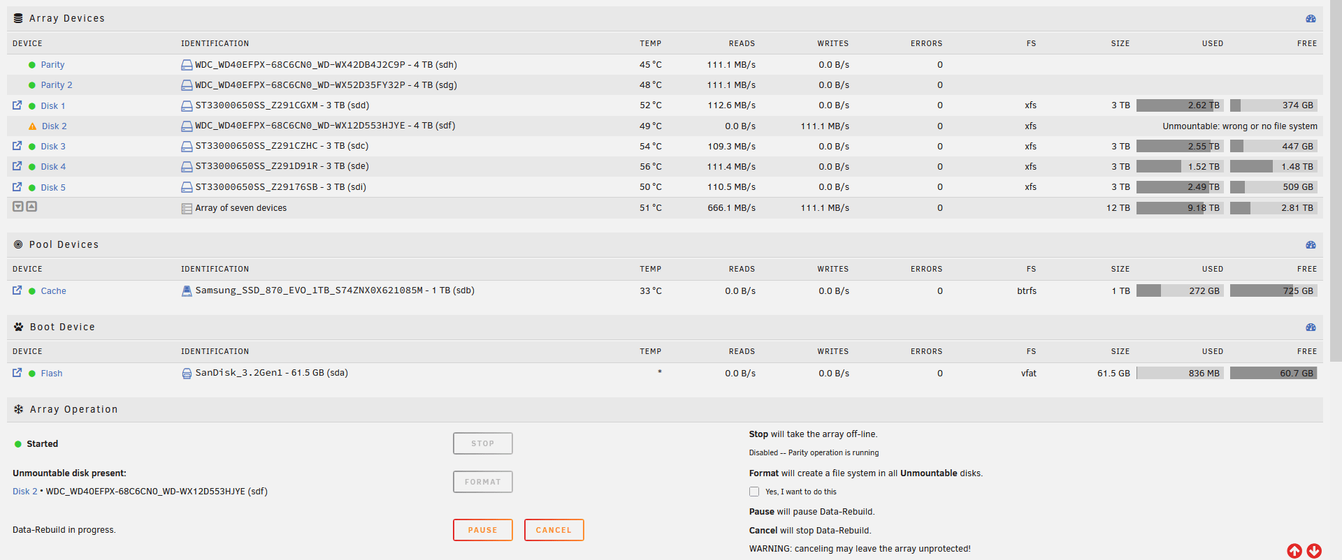

Replaced a hard drive, did a data rebuild but the disk is shows as unmountable.

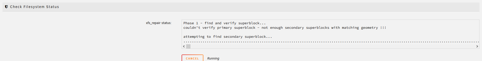

Recently replaced a drive and did the data rebuild to write the missing data to the new hard drive. While doing the data rebuild, I noticed a format option and mentioned in support at Discord, continued the data rebuild without formatting. Once the data rebuild was completed, Unraid still says that the disk is unmountable. Currently, the array is in maintenance mode, and I'm doing a check of the disk, and it mentions:
Phase 1 - find and verify superblock...
couldn't verify primary superblock - not enough secondary superblocks with matching geometry !!!
attempting to find secondary superblock...
Support mentioned to make a post here, so here I am. What should I do to resolve this issue?
I added the diagnostics as well as screenshots of what I saw for clarity’s sake.

Did you do the check filesystem from the webUI? Easy to get the command line wrong for this.
I followed the steps (Maintenance Mode, clicking Disk 2 and clicked on Check). No command line was used.
You may have to wait while it searches for secondary superblock.

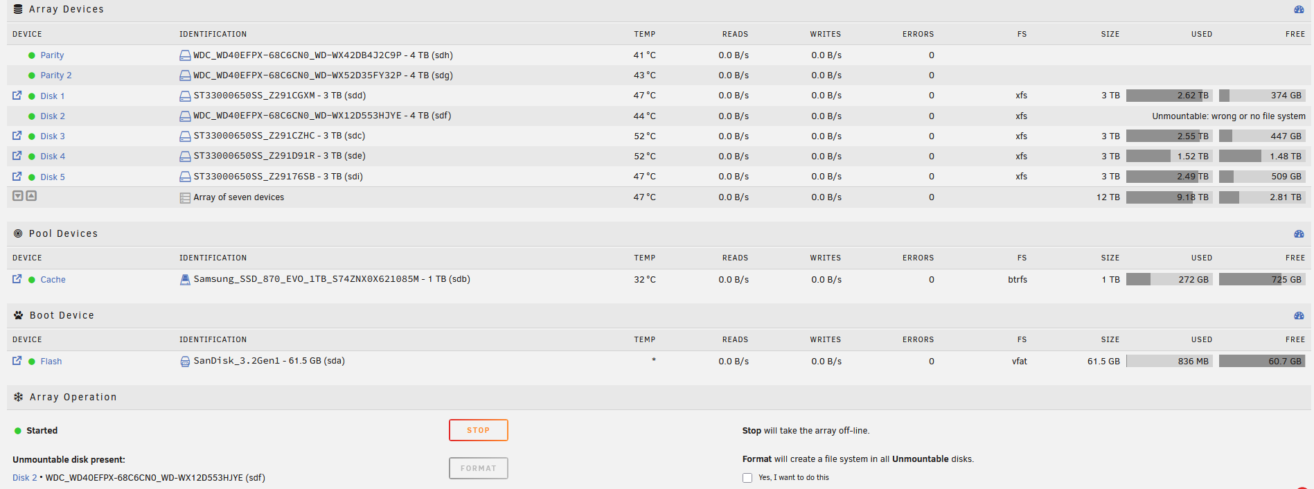

Ah, yes. Thank you. Forgotten about the emulated disk bit. Well, I'll let it run overnight and will get some rest. Will reply when there's any updates.
After memory is tested and working perfectly (even 1 error is too many), you could New Config the original disk back into the array and let parity rebuild, then try the replace/rebuild again.

No superblock found and memtest found no errors, so I'm just gonna start the rebuilding of the parity, and do what you said. Thank you for your time.
If you intend to New Config the original disk back into the array, then no point in building parity before that since parity must be rebuilt after the New Config.
Yeah, I placed the old hard drive back in and the server said that the old drive was smaller than what I tried to replace it with. So I just went with the New Config and started rebuilding the parity from there.
