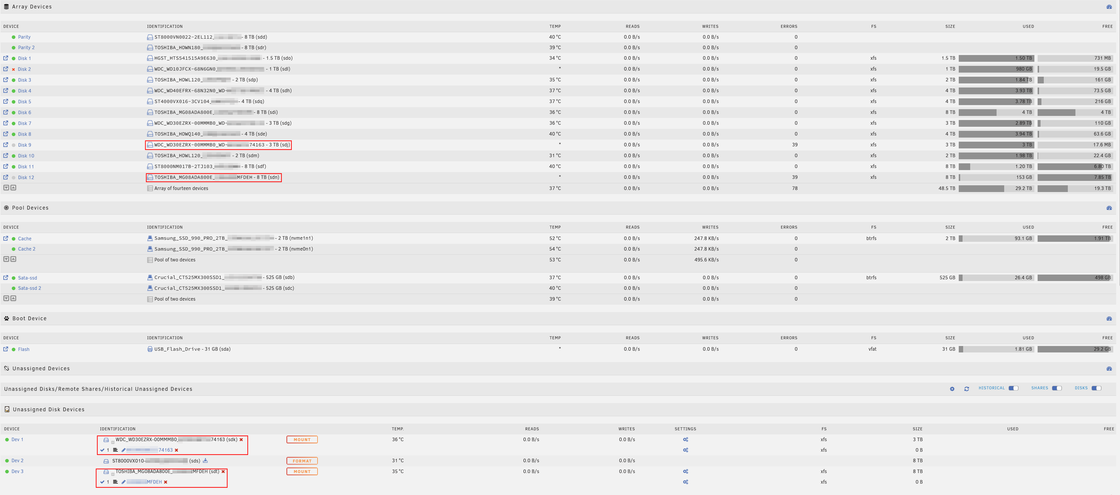

Was about to start to pre-clear the new disk, when I noticed a total of three unassigned devices on the dashboard - the new 8TB Seagate disk I was about to pre-clear and two disks that are also part of the array. Those still showed up in the array, but were also shown here, using different device designators (disk9 as sdj and disk 12 as sdn in the array, but as sdk and sdt in unassigned devices).

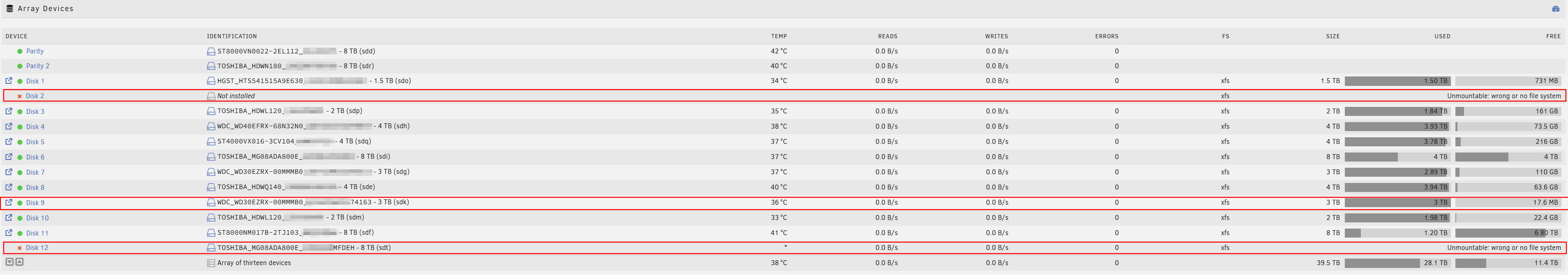

I stopped the array, set disk2 to empty (I planned on replacing disk2 with the new 8 TB drive after pre-clearing and rebuilding the contents there) and noticed that disk12 now also was disabled. I left the failed disk in the disk12 slot for now and restarted the array. The array right now is running but obviously is fully depending on the two parity disks it seems. Maybe this was just some sort of controller snafu that re-initialized the disks?

View of the array with the three unassigned devices:
View of the array now:
