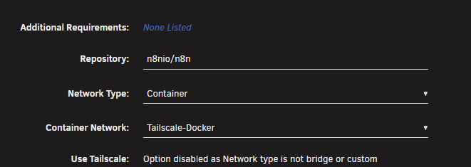

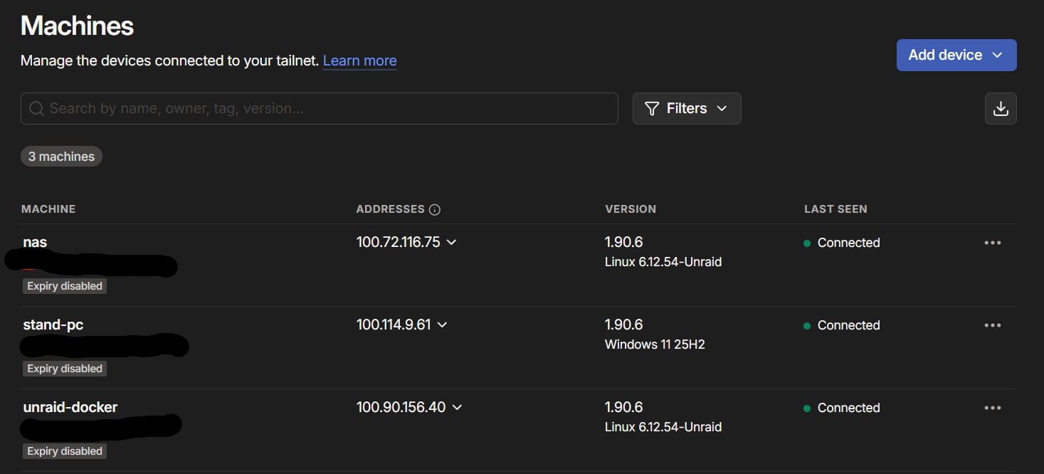

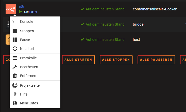

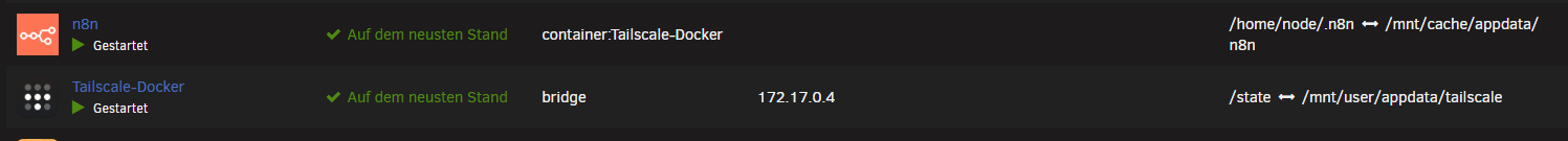

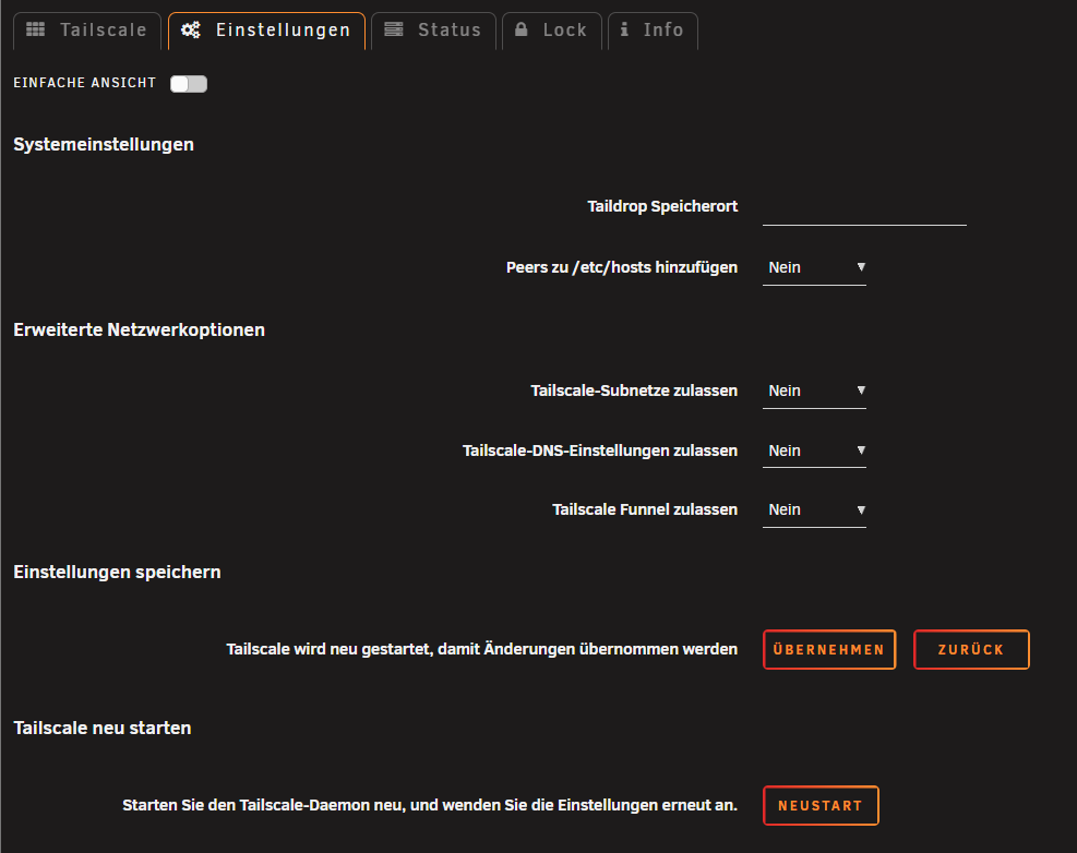

November 7, 20251 yr Hi,I want to run the n8n Docker on Unraid 7.2.0 and use Tailscale to solve the browser issue regarding the needed SSL certificate using Tailscale. (allowing Tailscale-Subnet is deactivated)I installed Tailscale on unraid and my Windows PC, set Tailnet DNS name and activated SSL.I am able to connect to Unraid using the .ts.net address with secure connection.Then I installed Tailscale-Docker and activated it in Tailscale too, and I can see the "unraid-docker" as a new mashine shown in the Tailscale mashines overview. For all mashines i deactivated SSL expiry.I installed n8n with "Networktype: Container" and "Container Network: Tailscale-Docker"Both (Tailscale-Docker and n8n) are started.BUT there is now GUI function available when i click on n8n, the only thing I can see is >_ Console.Can someone please show me what I have done wrong?With kind regardsingoHere some pictures:Tailscale:Docker:n8n Config:No GUI for n8n:Tailscale setting: Edited November 7, 20251 yr by Croco80

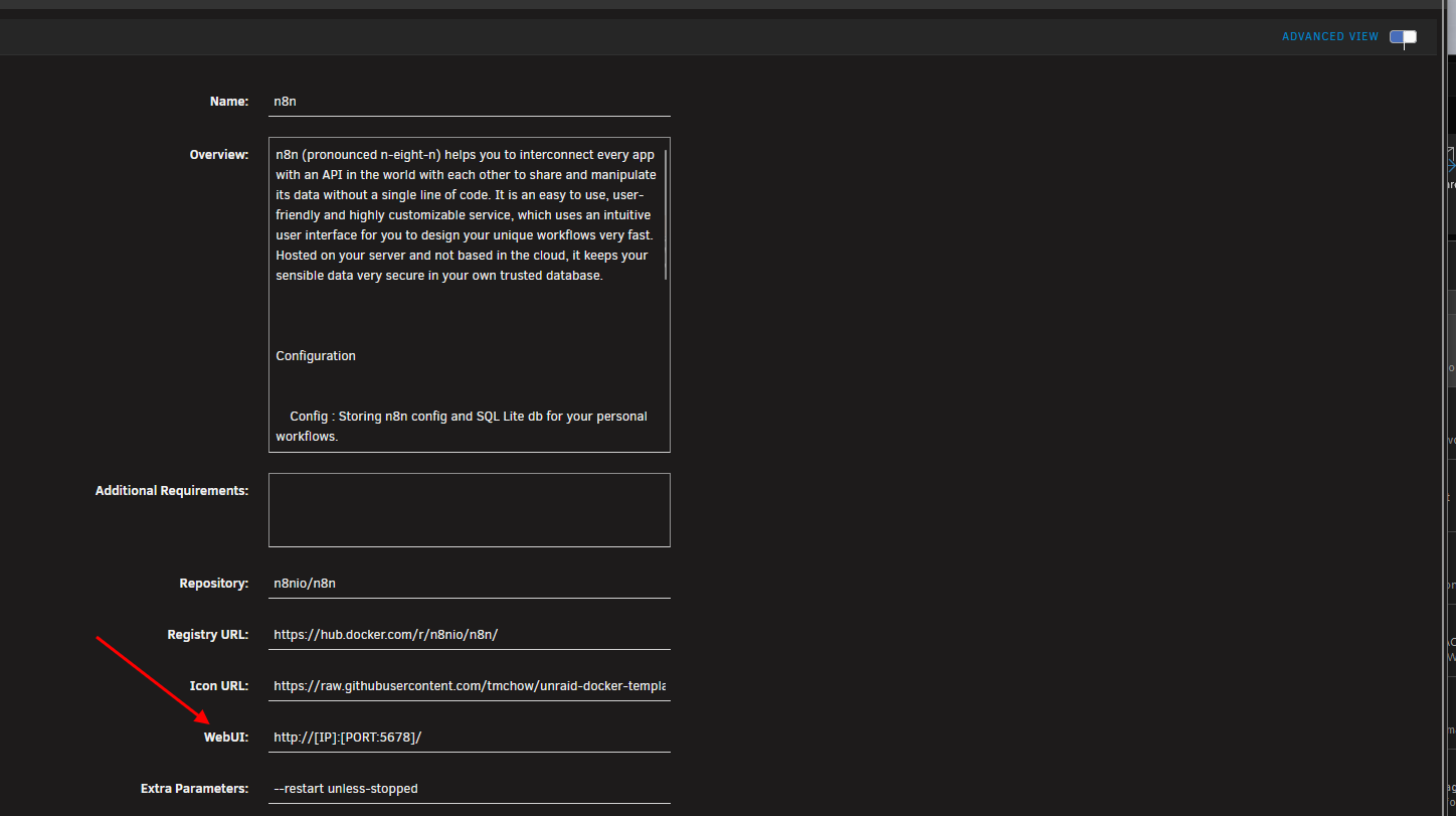

November 7, 20251 yr If you see only the "console" button that is because in the app image there "Web UI" part, that is under advanced view, is empty.This does not mean that your n8n is not accessible, you can still reach it using the tailscale container ip, and if you are using Magick DNS using the dns name from tailscale.Are you using Unraid 6 ? because in Unraid 7 you can install tailscale directly inside n8n in the app image.

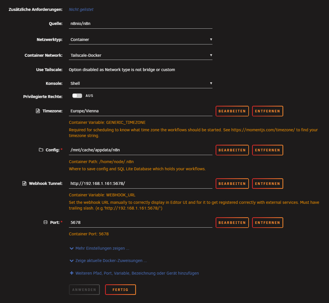

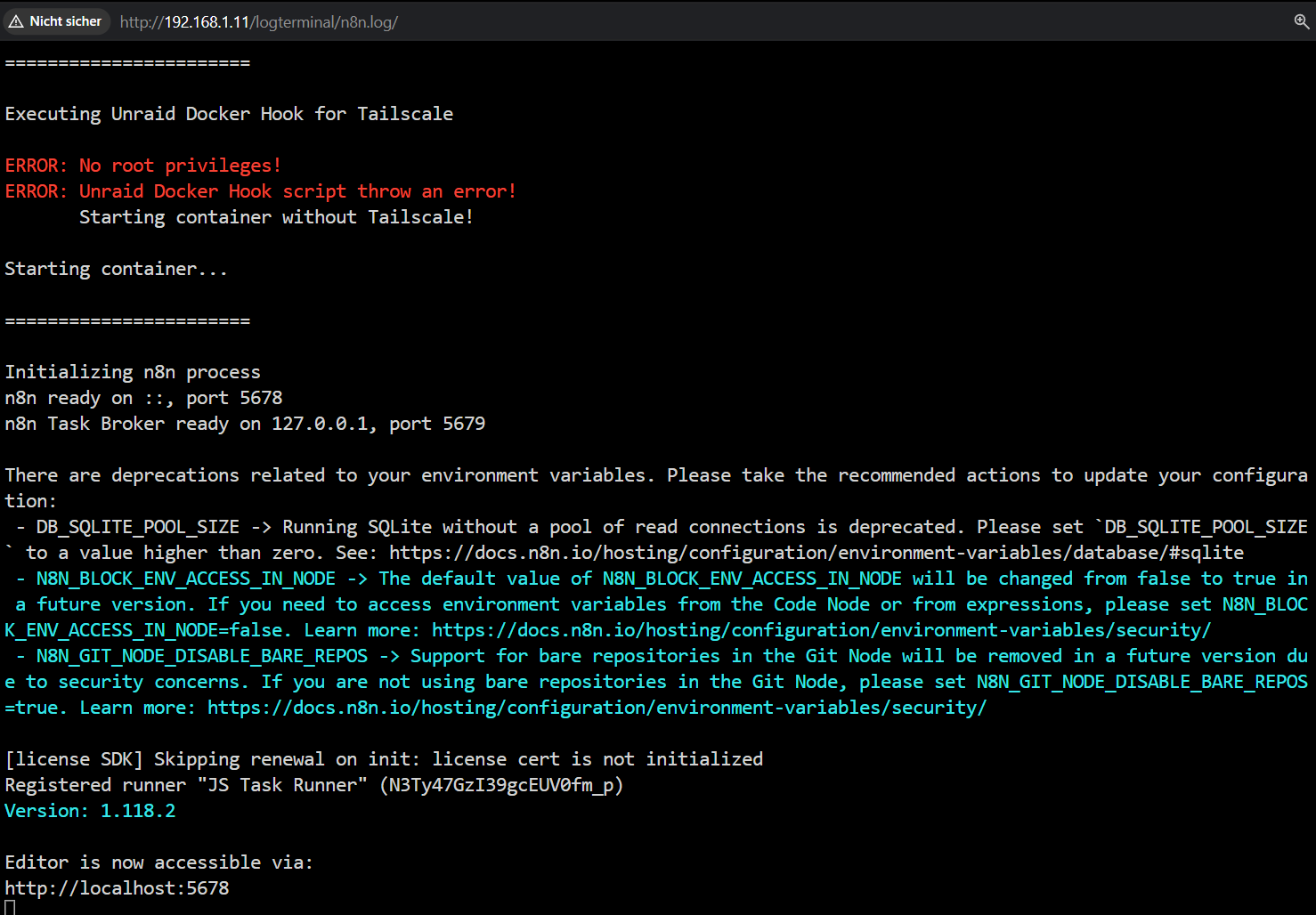

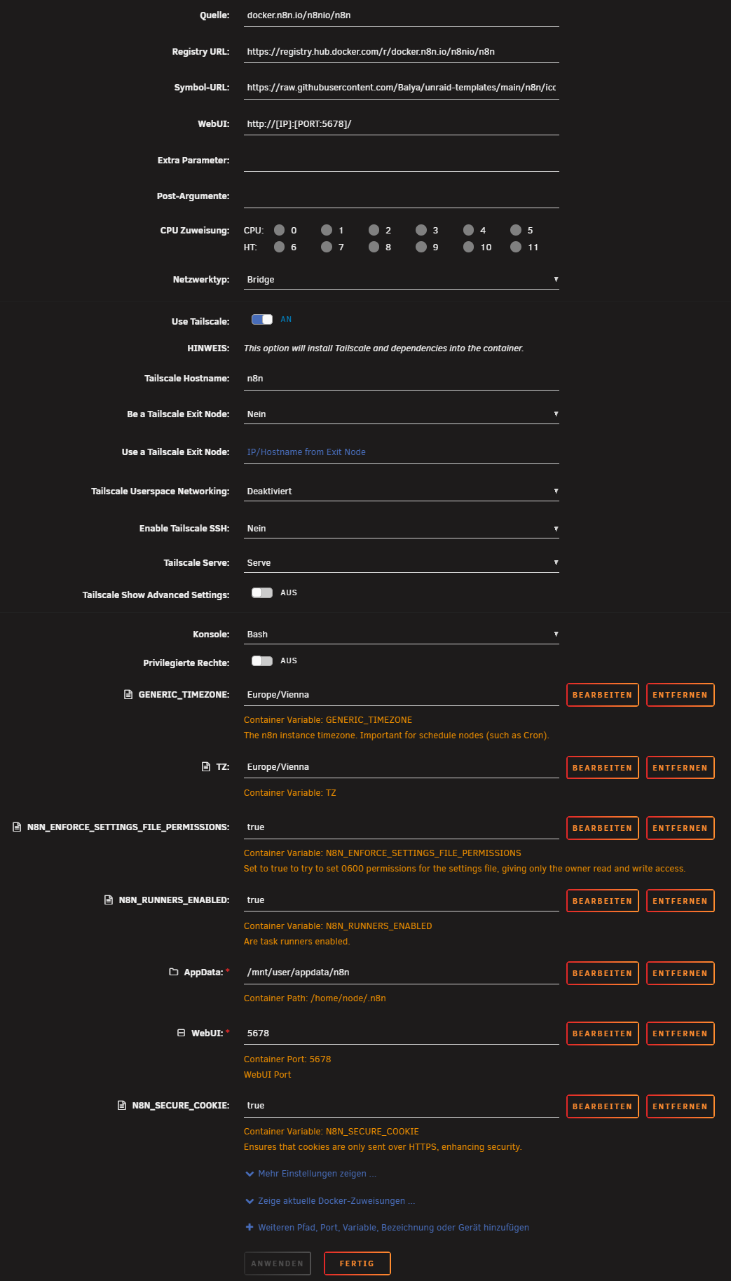

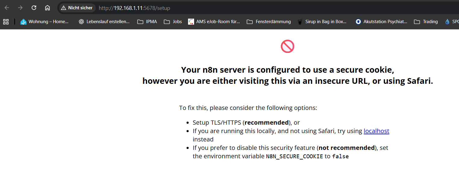

November 7, 20251 yr Author Hi Yusseiin,Thank you very much for your support.I am using Unraid 7.2.0 and n8n from tmchow`s Repositor, I think I missed this information in my Post.In my case I use 192.168.1.11:5678 as 192.168.1.11 is the IP of my Unraid in my network.I tried to configure Tailscale in the config of n8n BUT then I was not able to start n8n as privileges are missing. After some research I found the information that I should not set the privileges for user and group, but instead use tailscale-docker.This is what I see when I tried to configure Tailscale in n8n:And this is my n8n configuration I used:This was the reason why I tried to solve this topic using Tailscale-Docker as I´ve read that this should be a proper solution to my problem.But up to now I found no working solution.Not using Tailscale and SSL I get this message:To be honest I do not have any idea how to get this running. :-(
