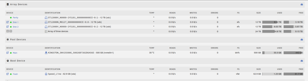

So i have a set up with array with 3 hdd's (1 for parity).
Then i also have an SSD already installed in my system. It is currently set up as a "pool" device.
I think the SSD is not being utilized at all so far.
So setup looks like this:

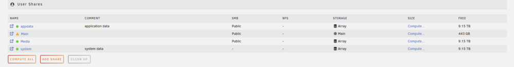

Shares setup look like this:
So "appdata" seems to be stored on the Array, rather than the "Main" SSD.

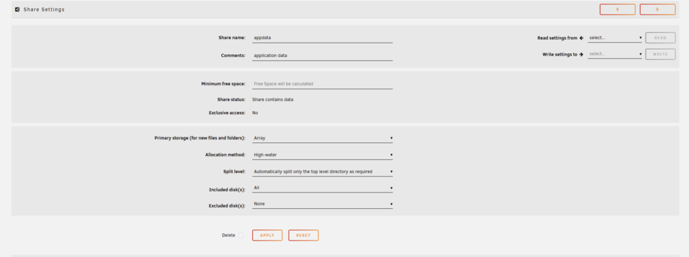

In the appdata share settings, i can see that i can change the "primary storage" to the "main".
But i'm unsure what actually happens in that case?
(current unchanged settings)

Go to appdata and system shares and set them both to Primary-Main; Secondary-Array; Mover Action-Array->Main.
Go to Main page - Array Operation, click Move, wait for it to complete.

appdata and system shares are all on Main pool now. That should improve docker performance since they will be running from SSD now, and it should also allow your array disks to spin down since the docker related files are typically open all the time, and they aren't on the array anymore.
You have a user share also named 'Main'. That might lead to mistakes in specifying paths in the future, so be careful with that.
