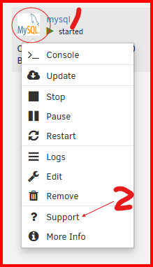

First, if you have installed a Docker container and you have questions about that container, you should be asking itin the support thread for that Container. You can find that by clicking on the 'Support' link for that Container. See here for an example:
IF nothing else, you should name the specific Container that you are having issues with.

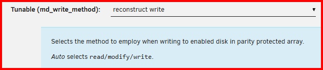

In a more general note, I do have my backup server set up to use 'reconstruct write' mode and I do not have a cache drive for the backup shares. The cache drive (500GB) could easily fill up when the backup is being done. These settings often allow the backup speed to be about 100MB/s depending on file size.
