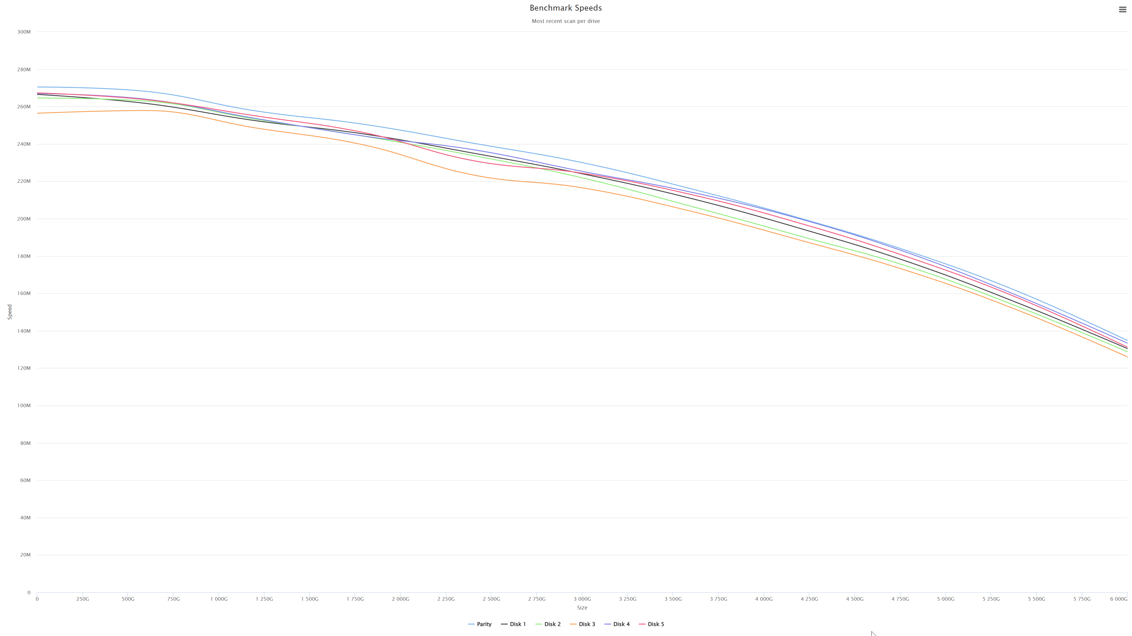

No obvious issues logged, though you are using a RAID controller, which is not recommended. You can run the diskspeed container to see if all disks are performing normally.
Thank you for this recommendation, I made it run through all of the hdd-s but they seem rather well grouped to my eyes.
Yep that looks fine, did you also run the controller tests, just to confirm they are still fast when accessed all together?

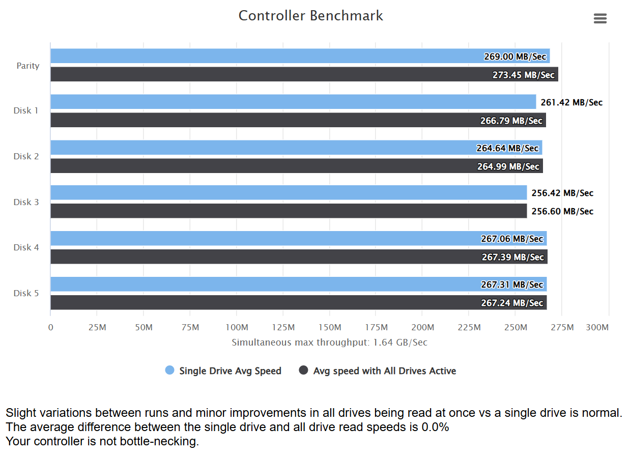

I did i think, but it still look fine to me. I'll try to look around in Intelligent Provisioning maybe it switched from hba mode at some point. Im at a complete loss right now.

It does, if it's still slow during a parity check, there could be a compatibility issue between the RAID controller or its driver and the Unraid driver.
