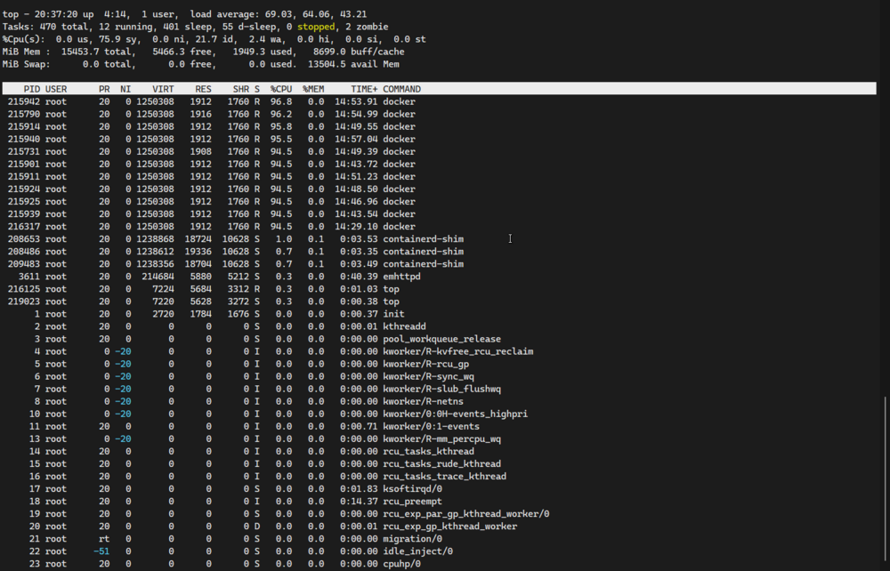

Looking at that screenshot suggests an issue with Docker, and the syslog also shows multiple Docker related call traces, e.g.
Nov 29 20:13:43 Unraid kernel: note: docker[199681] exited with preempt_count 1
Nov 29 20:13:43 Unraid kernel: Fixing recursive fault but reboot is needed!
Nov 29 20:13:43 Unraid kernel: BUG: using smp_processor_id() in preemptible [00000000] code: docker/199681
Recommend recreating the Docker image first:
https://docs.unraid.net/unraid-os/troubleshooting/common-issues/docker-troubleshooting/#re-creating-the-docker-image-file

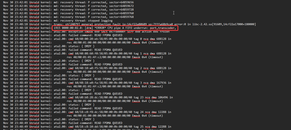

I found this igpu error in the syslog. May I know what does it means ?

I would be suspecting possibly an issue with the systemboard. While I don't know the reason for the igpu error listed above, your screenshot is also still calling out errors from ata2 and also a little bit further in the logs ata4.
I did have a look to see if there was a bios update for your machine, but it looks like it was updated not too long ago. Before version 7, I did have the issue where the GUI would become unresponsive but could ssh into it at least initially. It was having the web gui open for long periods would cause the issue. Interestingly, searching that syslog file, I don't see any reference to version 7 of unraid, I only see version 6.12.54 mentioned. (But I am no unraid guru.)
As mentioned by JorgeB above, I'd be checking out the hardware, try and run some diagnostics on the board and CPU to see if that helps. Good luck!
