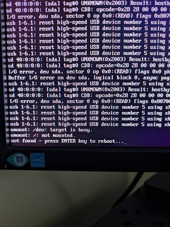

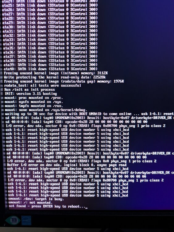

Just upgraded to 7.2.2 and it's not booting (see screenshots). It says the following and then say "hit enter to reboot". I'm going to continue troubleshooting and would prefer not have to reinstall the flash drive if avoidable. Please help.
umount /dev: target is busy
umount /: not mounted
not found - press ENTER key to reboot...

Looking at the screenshots, it looks like maybe the USB image got corrupted during the upgrade given the I/O errors for sda?
The screenshot definitely shows an issue with reading the flash drive. I would suggest downloading the zip file for the release and then extracting all the bz* type files overwriting the ones in the root of the flash drive. That often seems to help with this type of error happening just after an upgrade.
If that does not help you may have a genuine issue with the flash drive. While doing the action mentioned above I would recommend taking the opportunity to also make a backup of the ‘config’ folder from the flash drive as that contains all your configuration information.
