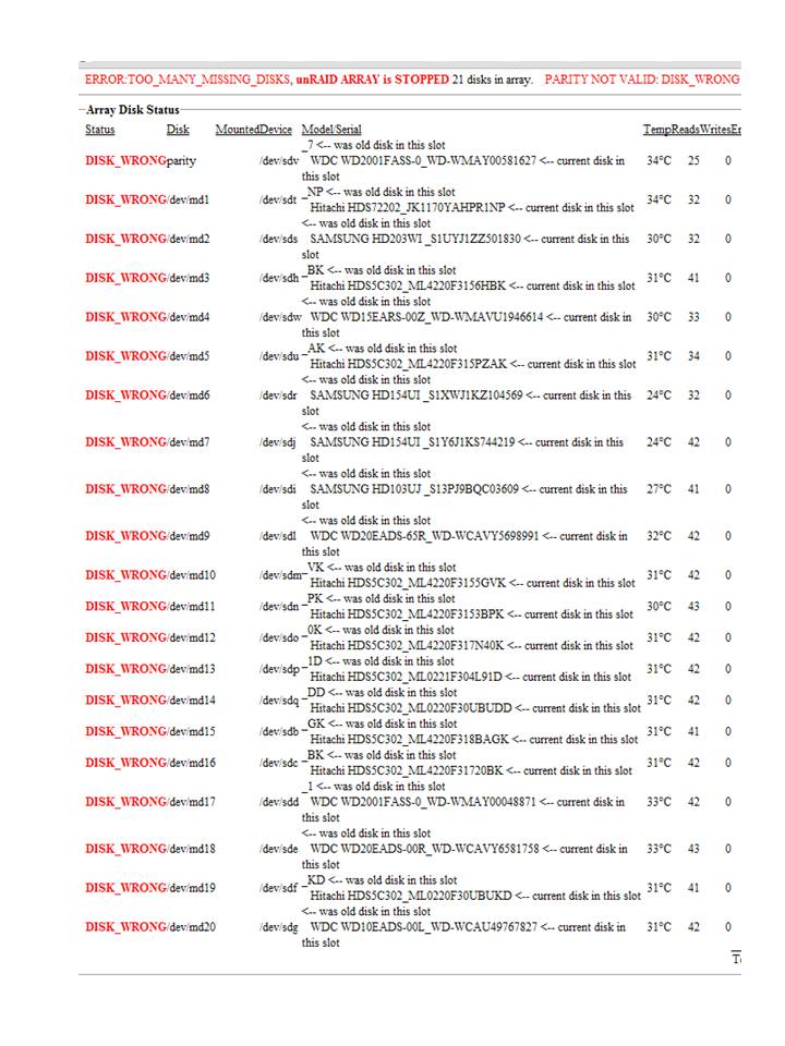

All my disks are shown as missing, but they're all there in devices tab. HELP!

Restarted and suddenly all disks were redballed. Under devices, the disks are all in the correct places and are assigned the right slots. See attachment in next message.

syslog.txt
