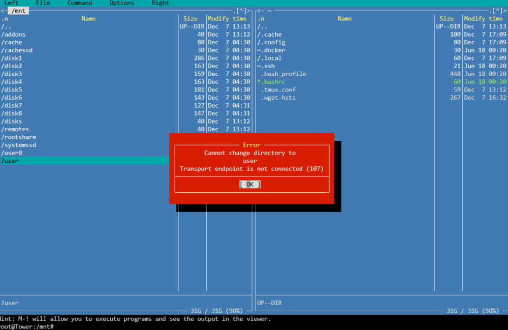

Help, share errors, started after 7.2.2 update
Can't say if 7.2.2 update is related, but I started seeing docker that would not start (execution error). I rolled back to 7.2.1 and thought everything was fine, and now I am seeing share issues like below in midnight commander. Diagnostics attached, can anyone shed some light or point me what I should be looking at as the issue? Nothing hardware wise has changed.
image.png.
tower-diagnostics-20251207-1712.zip
shfs is crashing; I can't see why. You'll need to reboot to reset it, but if you are not using NFS, I recommend disabling that, if you are really using it, I recommend only using it with exclusive shares or shares that only have primary storage set.
