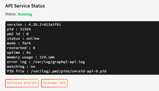

when is the connect plugin going to fix the api and graph stuff...

Starting Unraid API service
DEBUG: Checking PATH: .:/usr/local/sbin:/usr/sbin:/sbin:/usr/local/bin:/usr/bin:/bin
DEBUG: Checking if unraid-api files exist:
total 20
drwxr-xr-x 1 root root 100 Dec 16 10:48 .
drwxr-xr-x 1 root root 320 Dec 18 13:01 ..
drwxr-xr-x 1 root root 740 Dec 16 10:48 assets
-rwxr-xr-x 1 root root 1419 Dec 16 10:48 cli.js
-rwxr-xr-x 1 root root 15204 Dec 16 10:48 main.js
DEBUG: Checking symlink:
lrwxrwxrwx 1 root root 25 Dec 18 13:01 /usr/local/bin/unraid-api -> ../unraid-api/dist/cli.js
DEBUG: Checking Node.js version:
v22.18.0
DEBUG: Checking if cli.js is executable:
-rwxr-xr-x 1 root root 1419 Dec 16 10:48 /usr/local/unraid-api/dist/cli.js
DEBUG: Attempting to run unraid-api directly:
Unraid API v4.28.2+d13a1f61
If no additional messages appear within 30 seconds, it is safe to refresh the page.
Added bundled plugin unraid-api-plugin-connect
Starting Unraid API service...
Starting flash backup service...
Starting the Unraid API
[PM2][WARN] Applications unraid-api not running, starting...
[PM2][WARN] App unraid-api has option 'wait_ready' set, waiting for app to be ready...
[PM2] App [unraid-api] launched (1 instances)
+--- unraid-api
namespace : default
version : 4.28.2+d13a1f61
pid : 257520
pm2 id : 0
status : online
mode : fork
restarted : 0
uptime : 1s
memory usage : 209.6mb
error log : /var/log/graphql-api.log
watching : no
PID file : /var/log/.pm2/pids/unraid-api-0.pid
Unraid API service started
✅ Installation is complete, it is safe to close this window

[19:12:30 INFO RCloneApiService]: RCloneApiService module destroyed {"apiVersion":"4.28.2+d13a1f61","logger":"api","context":"RCloneApiService"}
[19:12:30 WARN UpnpService]: UPNP Mapping removal failed. Missing ports: {} {"apiVersion":"4.28.2+d13a1f61","logger":"api","context":"UpnpService"}
[19:12:32 INFO app]: ENV {"API_VERSION":"4.28.2+d13a1f61","BYPASS_CORS_CHECKS":false,"BYPASS_PERMISSION_CHECKS":false,"CHOKIDAR_USEPOLLING":false,"DEBUG":false,"ECOSYSTEM_PATH":"/usr/local/unraid-api/ecosystem.config.json","ENABLE_NEXT_DOCKER_RELEASE":false,"ENVIRONMENT":"production","GRAPHQL_INTROSPECTION":false,"INTROSPECTION":false,"IS_DOCKER":false,"LOG_CORS":false,"LOG_LEVEL":"INFO","LOG_TYPE":"pretty","MOTHERSHIP_GRAPHQL_LINK":"https://mothership.unraid.net/ws","NODE_ENV":"production","PATHS_CONFIG_MODULES":"/boot/config/plugins/dynamix.my.servers/configs","PATHS_LOCAL_SESSION_FILE":"/var/run/unraid-api/local-session","PATHS_LOGS_DIR":"/var/log/unraid-api","PATHS_LOGS_FILE":"/var/log/graphql-api.log","PM2_HOME":"/var/log/.pm2","PM2_PATH":"/usr/local/unraid-api/node_modules/pm2/bin/pm2","PORT":"/var/run/unraid-api.sock","SUPPRESS_LOGS":false,"environment":{"IS_MAIN_PROCESS":true}} {"apiVersion":"4.28.2+d13a1f61"}
[19:12:32 INFO app]: PATHS {"core":"/usr/local/unraid-api/dist/assets","unraid-api-base":"/usr/local/unraid-api/","unraid-data":"/boot/config/plugins/dynamix.my.servers/data","docker-autostart":"/var/lib/docker/unraid-autostart","docker-socket":"/var/run/docker.sock","rclone-socket":"/var/run/rclone.socket","parity-checks":"/boot/config/parity-checks.log","htpasswd":"/etc/nginx/htpasswd","emhttpd-socket":"/var/run/emhttpd.socket","states":"/usr/local/emhttp/state","dynamix-base":"/boot/config/plugins/dynamix","dynamix-config":["/usr/local/emhttp/plugins/dynamix/default.cfg","/boot/config/plugins/dynamix/dynamix.cfg"],"myservers-base":"/boot/config/plugins/dynamix.my.servers/","myservers-config":"/boot/config/plugins/dynamix.my.servers/myservers.cfg","myservers-config-states":"/usr/local/emhttp/state/myservers.cfg","myservers-keepalive":"/boot/config/plugins/dynamix.my.servers/fb_keepalive","keyfile-base":"/boot/config","machine-id":"/var/lib/dbus/machine-id","log-base":"/var/log/unraid-api","unraid-log-base":"/var/log","var-run":"/var/run","auth-sessions":"/var/lib/php","auth-keys":"/boot/config/plugins/dynamix.my.servers/keys","passwd":"/boot/config/passwd","libvirt-pid":"/var/run/libvirt/libvirtd.pid","activationBase":"/boot/config/activation","webGuiBase":"/usr/local/emhttp/webGui","identConfig":"/boot/config/ident.cfg","activation":{"assets":"/boot/config/activation/assets","logo":"/boot/config/activation/assets/logo.svg","caseModel":"/boot/config/activation/assets/case-model.png","banner":"/boot/config/activation/assets/banner.png"},"boot":{"caseModel":"/boot/config/plugins/dynamix/case-model.png","caseModelConfig":"/boot/config/plugins/dynamix/case-model.cfg"},"webgui":{"imagesBase":"/usr/local/emhttp/webGui/images","logo":{"fullPath":"/usr/local/emhttp/webGui/images/UN-logotype-gradient.svg","assetPath":"/webGui/images/UN-logotype-gradient.svg"},"caseModel":{"fullPath":"/usr/local/emhttp/webGui/images/case-model.png","assetPath":"/webGui/images/case-model.png"},"banner":{"fullPath":"/usr/local/emhttp/webGui/images/banner.png","assetPath":"/webGui/images/banner.png"}}} {"apiVersion":"4.28.2+d13a1f61"}
[19:12:32 INFO app]: Config directory ready {"apiVersion":"4.28.2+d13a1f61"}
[19:12:32 INFO app]: Emhttp state loaded {"apiVersion":"4.28.2+d13a1f61"}
[19:12:32 INFO app]: Registration key loaded {"apiVersion":"4.28.2+d13a1f61"}
[19:12:32 INFO app]: Dynamix config loaded {"apiVersion":"4.28.2+d13a1f61"}
[19:12:32 INFO app]: State manager initialized {"apiVersion":"4.28.2+d13a1f61"}
[19:12:32 INFO app]: Registration key watch active {"apiVersion":"4.28.2+d13a1f61"}
[19:12:32 INFO app]: Bootstrapping NestJS server (budget: 29798ms)... {"apiVersion":"4.28.2+d13a1f61"}
[19:12:32 INFO api]: Starting Nest Server on Port / Path: /var/run/unraid-api.sock {"apiVersion":"4.28.2+d13a1f61","logger":"api"}
[19:12:32 INFO RoutesResolver]: RestController {/}: {"apiVersion":"4.28.2+d13a1f61","logger":"api","context":"RoutesResolver"}
[19:12:32 INFO RouterExplorer]: Mapped {/, GET} route {"apiVersion":"4.28.2+d13a1f61","logger":"api","context":"RouterExplorer"}
[19:12:32 INFO RouterExplorer]: Mapped {/graphql/api/customizations/:type, GET} route {"apiVersion":"4.28.2+d13a1f61","logger":"api","context":"RouterExplorer"}
[19:12:32 INFO RouterExplorer]: Mapped {/graphql/api/auth/oidc/authorize/:providerId, GET} route {"apiVersion":"4.28.2+d13a1f61","logger":"api","context":"RouterExplorer"}
[19:12:32 INFO RouterExplorer]: Mapped {/graphql/api/auth/oidc/callback, GET} route {"apiVersion":"4.28.2+d13a1f61","logger":"api","context":"RouterExplorer"}
[19:12:32 WARN RCloneService]: RClone API service is not initialized, skipping provider info loading {"apiVersion":"4.28.2+d13a1f61","logger":"api","context":"RCloneService"}
[19:12:32 INFO UnraidFileModificationService]: Loading file modifications... {"apiVersion":"4.28.2+d13a1f61","logger":"api","context":"UnraidFileModificationService"}
[19:12:32 INFO CustomizationService]: CustomizationService initialized with paths from store. {"apiVersion":"4.28.2+d13a1f61","logger":"api","context":"CustomizationService"}
[19:12:32 INFO CustomizationService]: Activation directory /boot/config/activation not found. Skipping activation setup. {"apiVersion":"4.28.2+d13a1f61","logger":"api","context":"CustomizationService"}
[19:12:32 INFO ConnectPluginModule]: Connect plugin initialized with {"mothership":{"status":"PRE_INIT"},"dynamicRemoteAccess":{"runningType":"DISABLED","error":null,"lastPing":null,"allowedUrl":null},"config":{"wanaccess":false,"wanport":0,"upnpEnabled":true,"apikey":"***REDACTED***","localApiKey":"***REDACTED***","email":REDACTD!~","avatar":"","regWizTime":"","dynamicRemoteAccessType":"UPNP"}} {"apiVersion":"4.28.2+d13a1f61","logger":"api","context":"ConnectPluginModule"}
[19:12:32 INFO GraphQLModule]: Mapped {/graphql, POST} route {"apiVersion":"4.28.2+d13a1f61","logger":"api","context":"GraphQLModule"}
[19:12:32 INFO MothershipGraphqlClientService]: Connecting to wss://mothership.unraid.net/ws {"apiVersion":"4.28.2+d13a1f61","logger":"api","context":"MothershipGraphqlClientService"}
[19:12:32 WARN VmsService]: Initial hypervisor connection failed: Libvirt is not running. Setting up watcher. {"apiVersion":"4.28.2+d13a1f61","logger":"api","context":"VmsService"}
[19:12:32 INFO NestApplication]: Nest application successfully started {"apiVersion":"4.28.2+d13a1f61","logger":"api","context":"NestApplication"}
[19:12:32 INFO api]: Server listening on /var/run/unraid-api.sock {"apiVersion":"4.28.2+d13a1f61","logger":"api"}
[19:12:32 INFO api]: Nest Server is now listening {"apiVersion":"4.28.2+d13a1f61","logger":"api"}
[19:12:32 INFO app]: Startup complete in 911ms {"apiVersion":"4.28.2+d13a1f61"}
[19:12:33 INFO MothershipGraphqlClientService]: Connected to wss://mothership.unraid.net/ws {"apiVersion":"4.28.2+d13a1f61","logger":"api","context":"MothershipGraphqlClientService"}
[19:12:42 INFO VmsService]: Attempting to initialize VMs service...attempt 1/12 {"apiVersion":"4.28.2+d13a1f61","logger":"api","context":"VmsService"}
[19:12:42 WARN VmsService]: Initial hypervisor connection failed: Libvirt is not running. Setting up watcher. {"apiVersion":"4.28.2+d13a1f61","logger":"api","context":"VmsService"}
[19:12:52 INFO VmsService]: Attempting to initialize VMs service...attempt 2/12 {"apiVersion":"4.28.2+d13a1f61","logger":"api","context":"VmsService"}
[19:12:52 WARN VmsService]: Initial hypervisor connection failed: Libvirt is not running. Setting up watcher. {"apiVersion":"4.28.2+d13a1f61","logger":"api","context":"VmsService"}
[19:12:02 INFO VmsService]: Attempting to initialize VMs service...attempt 3/12 {"apiVersion":"4.28.2+d13a1f61","logger":"api","context":"VmsService"}
[19:12:02 WARN VmsService]: Initial hypervisor connection failed: Libvirt is not running. Setting up watcher. {"apiVersion":"4.28.2+d13a1f61","logger":"api","context":"VmsService"}
[19:12:12 INFO VmsService]: Attempting to initialize VMs service...attempt 4/12 {"apiVersion":"4.28.2+d13a1f61","logger":"api","context":"VmsService"}
[19:12:12 WARN VmsService]: Initial hypervisor connection failed: Libvirt is not running. Setting up watcher. {"apiVersion":"4.28.2+d13a1f61","logger":"api","context":"VmsService"}
[19:12:22 INFO VmsService]: Attempting to initialize VMs service...attempt 5/12 {"apiVersion":"4.28.2+d13a1f61","logger":"api","context":"VmsService"}
[19:12:22 WARN VmsService]: Initial hypervisor connection failed: Libvirt is not running. Setting up watcher. {"apiVersion":"4.28.2+d13a1f61","logger":"api","context":"VmsService"}
[19:12:32 INFO VmsService]: Attempting to initialize VMs service...attempt 6/12 {"apiVersion":"4.28.2+d13a1f61","logger":"api","context":"VmsService"}
[19:12:42 INFO VmsService]: Attempting to initialize VMs service...attempt 7/12 {"apiVersion":"4.28.2+d13a1f61","logger":"api","context":"VmsService"}
[19:12:52 INFO VmsService]: Attempting to initialize VMs service...attempt 8/12 {"apiVersion":"4.28.2+d13a1f61","logger":"api","context":"VmsService"}
[19:12:02 INFO VmsService]: Attempting to initialize VMs service...attempt 9/12 {"apiVersion":"4.28.2+d13a1f61","logger":"api","context":"VmsService"}
[19:12:12 INFO VmsService]: Attempting to initialize VMs service...attempt 10/12 {"apiVersion":"4.28.2+d13a1f61","logger":"api","context":"VmsService"}
[19:12:22 INFO VmsService]: Attempting to initialize VMs service...attempt 11/12 {"apiVersion":"4.28.2+d13a1f61","logger":"api","context":"VmsService"}
[19:12:32 INFO VmsService]: Attempting to initialize VMs service...attempt 12/12 {"apiVersion":"4.28.2+d13a1f61","logger":"api","context":"VmsService"}
root@BMM-Tower:~#
Edited by bmartino1
email / username was shown in logs...
lattest update seems to have fixed most if not all of my errors
2025.12.19.2020
 up-to-date
